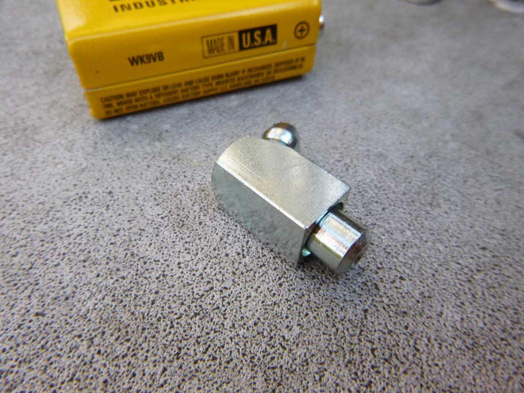

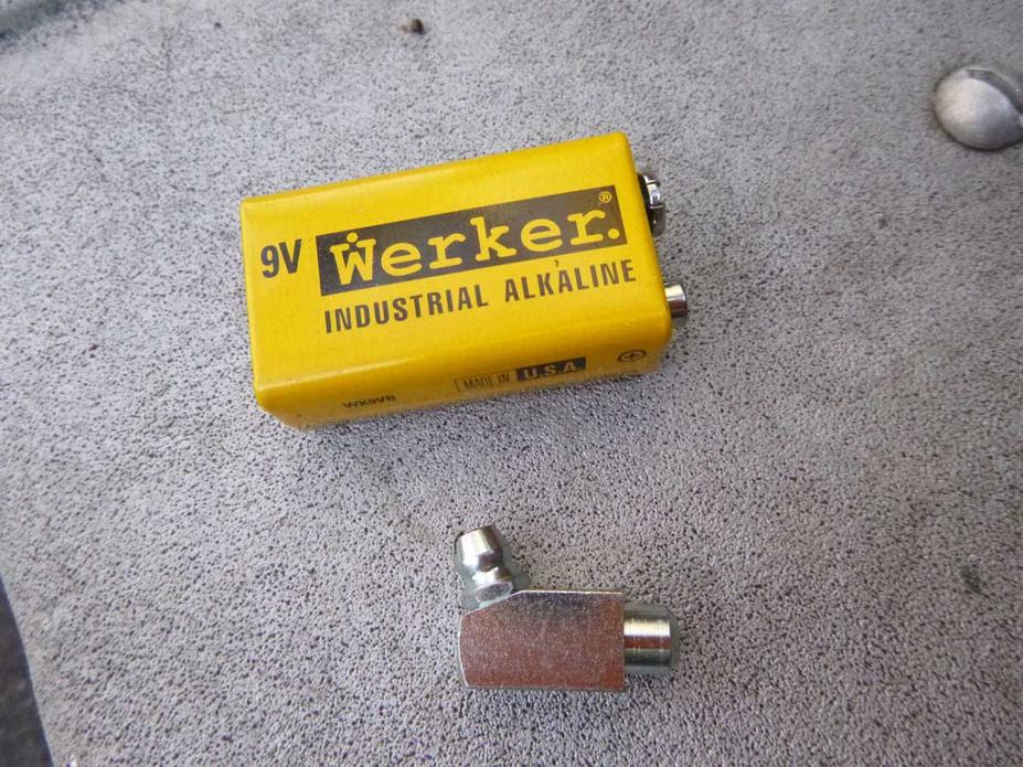

Here's the fitting. It's the square thing that the zerk is screwed into. I wish I had checked out what Chuckles stuck back on. We'll probably be pulling the rear yoke off to be able to hammer in in the hole. First going to try and see if we can get to it by just unhooking the rear attachement to the rear diff. Luckily he did get grease in it before it fell off.

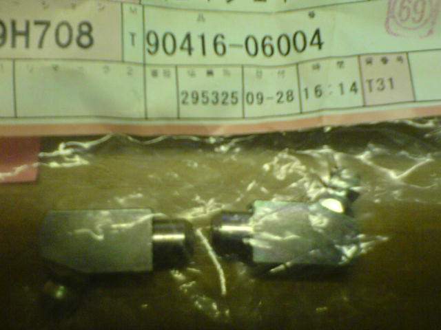

Hard as this is to believe, there is indeed a pressed in zerk fitting in some locations on 4Runner driveshafts.The item pictured, the one without threads, is the zerk as supplied by Toyota. I, too, had a missing zerk on a '97 4Runner. In my case, it was on the forward spider of the front driveshaft. I ordered another and pressed = well, tapped - it in. It was about $11. I had to remove that driveshaft in order to do so.
Yes, one wonders why Toyota did this.
I'll try and get a pic, but yes these are common on Toyota U-joints. It's right in the middle of the cross. Not much room to get in there. Hopefully the joint will swing over enough to get it in.
The zerk screws into the square piece.
