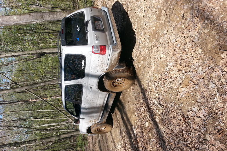

Well thanks for all the input....my mechanic replaced the U joint on the aft end of my drive shaft. The U joint on the car was just ruined but what a difference...no more chunking noises or humming or vibrating over 60mph. I was going to do the job myself I have plenty of experience working on cars but I always second guess myself when it comes to drive train work. Thanks for the responses! Sorry my picture uploaded sideways...I uploaded it from my phone
