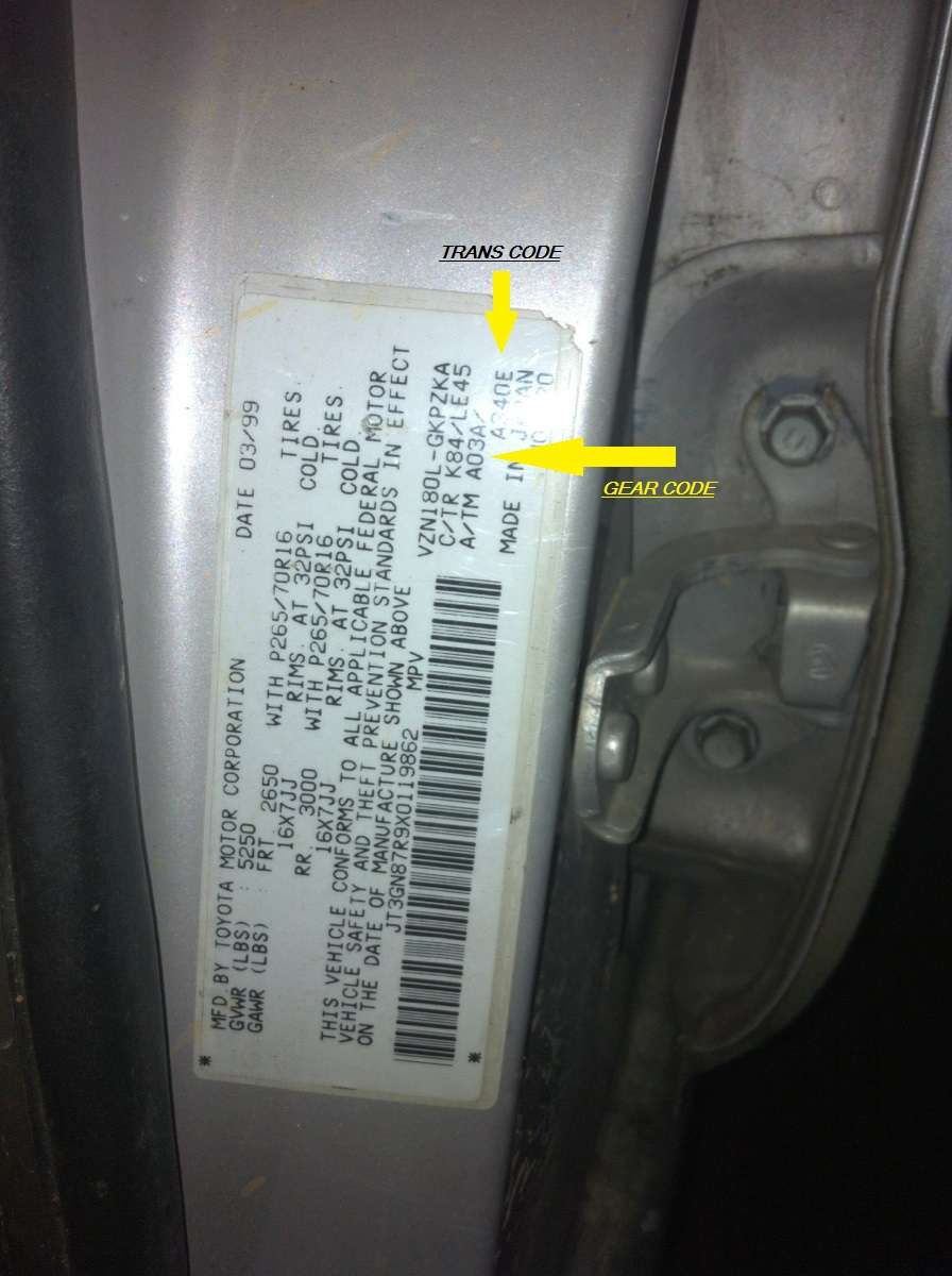

If you have 4.10s in the truck, the gear code will be A03A.
A=7.5" Ring Gear
03= 4.10 Gear
A=2 pinion open

Here's a Pic

wow thank you sir! the truck should get arrive today, I'm going to ask someone to check for me. Appreciate it!
just want to verify its in the door jamb? sorry for the dummy question, but Im explaining via phone to someone not very technical and with 0 knowledge of the truck. I asked to look in door jambs and she said she saw nothing :help:

Nope, this is wrong. The guides and tables aren't accurate. For example, my axle code is A04A, but I have a 4.3 gear ratio. You need to do the spin test, don't believe any guides online.
The best guideline for this is that you have a 4.10 unless you have an automatic e-locker, then you have 4.30. The 4.56 I think was an older carry-over and was very rare in the 3rd gen.
