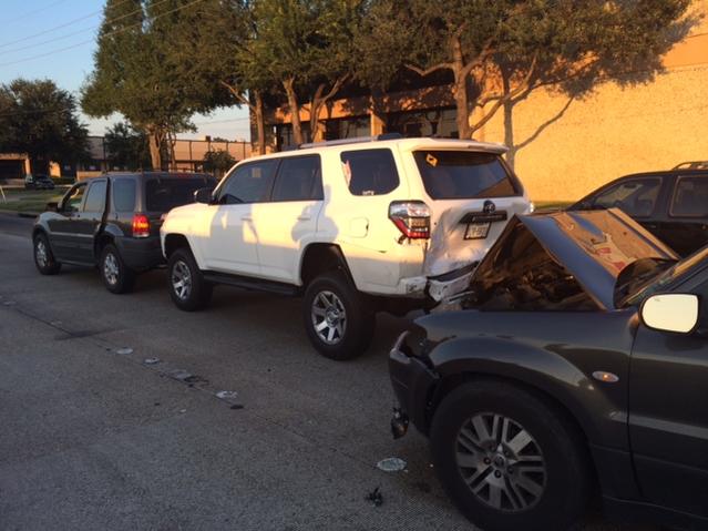

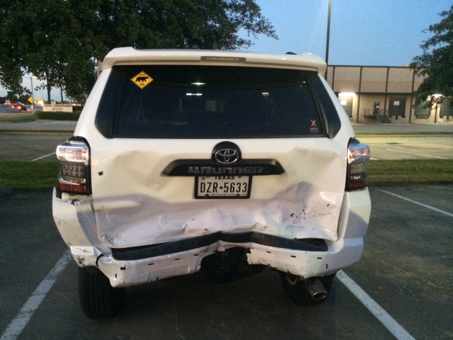

So, not even a month old and some dumb bi@$% crashed into me while I stopped for a car in front of me. The best part is she gave the police office an expired insurance and she got away without a ticket!! (She was taken to the hospital, she was bleeding through her nose.)
Luckily for me, the seat broke before I did. (I actually hit the head rest so hard it broke off).
Now my question is, do you guys think my car should be totaled? The frame piece where the factory hitch is installed was bent inward so much the spare tire is now wedged between it and the rear axle.
Unfortunately I didn’t take pictures from underneath, but the longitudinal pieces of the frame seemed ok, except for where they meet that cross member at the back.
Any input is greatly appreciated!

thats pretty gnarley.... not sure about a total though, whats the front look like? Hopefully you requested to be taken to the hospital and didnt waive treatment.... you might be OK right now but a week or even a year from now you might not be.... I would milk that dumbass for everything
Unfortunately for you, that's easily fixable. Make sure the shop either you or your insurance company send you to has a lifetime warranty on their work.

The insurance sent it to the dealer I bought it from. and yes I understand that is easily fixable, just cutting the old one and welding a new piece in place. But would that meet the factory standards?
Adding a weld on a truss that handles most of the towing weight and rear collision protection, is there a concern for fatigue failure, hardness issues or just overall strength?
I would have the same concern. Isn't that technically part of the frame and bent frame = total?
Yes. Toyota sells that (and the other crossmembers) as standard OEM parts and has a manual on properly repairing. That rear cross member is $750 and 3 hours of labor to replace. Probably need the crossmember for the spare carrier, too, another $300.
Easily replaced section of the frame.
MSRP on an entire frame is $5,850 and 36 hours of labor to replace, so nowhere near the new cost of a 4runner.
Bent frame does not equal totaled. That seems to be an old school of thought, but not reality.
I know someone who had the entire passenger side frame replaced on a ten year chevy truck due to a wreck.
