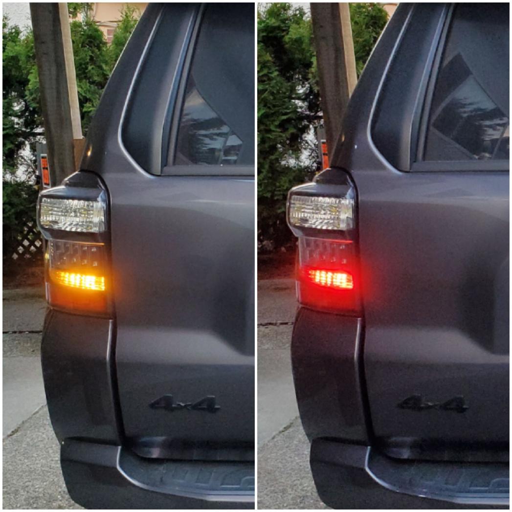

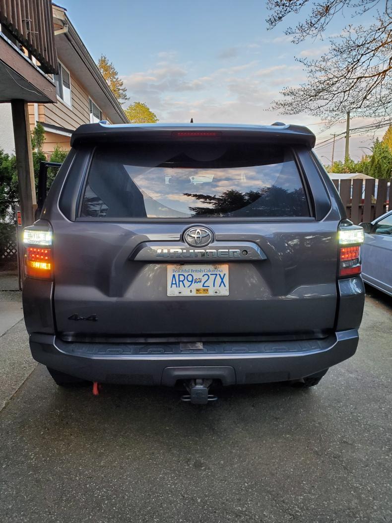

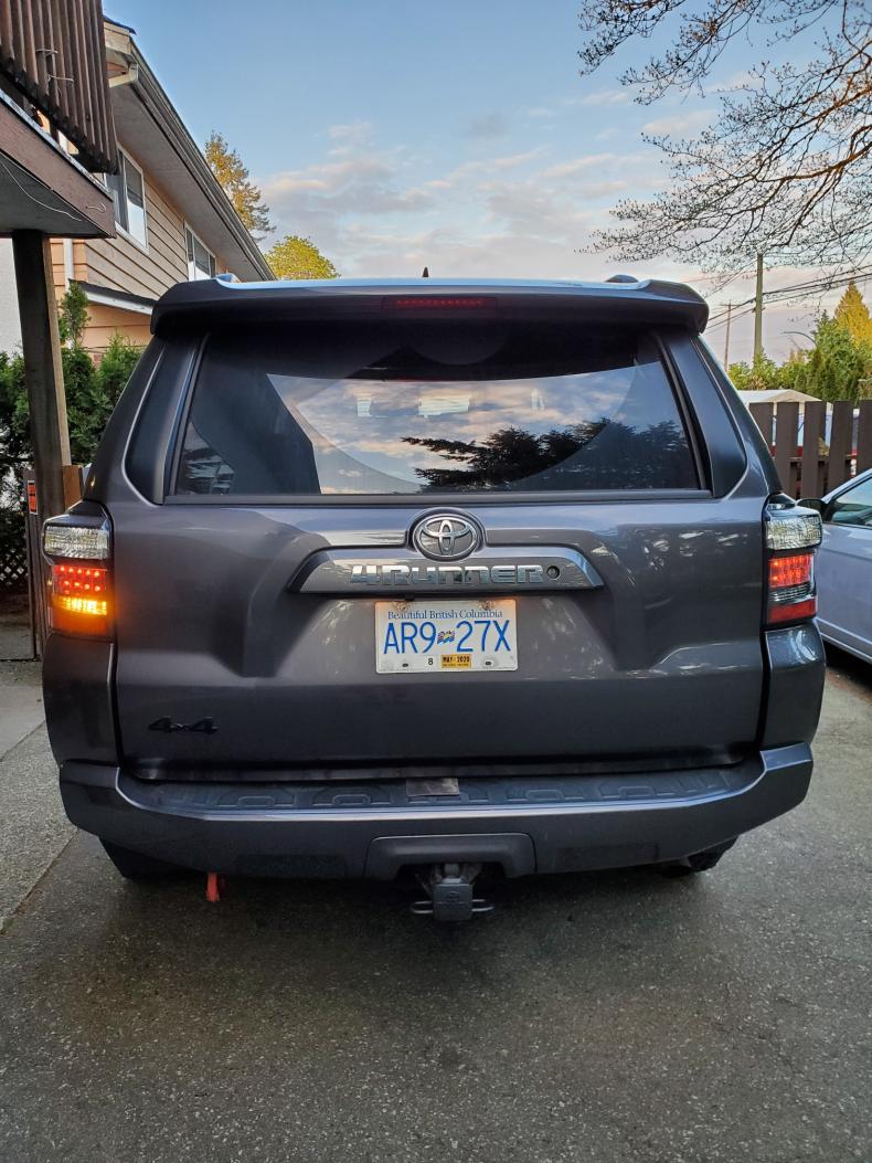

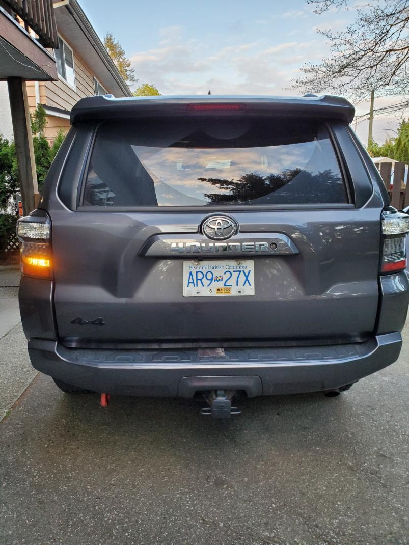

Added an OEM looking, rear fog light. Looking at proper usage online via articles and videos it does increase visibility in foggy/heavy rainfall conditions. I believe this is standard in the JDM/EDM market and I'm surprised why it's not standard on North American vehicles. I believe red is the usual colour for a rear fog light but I settled on amber (VLED). I tried red and found that it blends with the tail lights and just looks like one tail light is out. I chose amber because it differentiates from tail lights and had a higher lumen output than red, also from VLED.
I have the Diode Dynamics Tail as Turn mod which can provide reverse lights in 2 locations, the factory turn signal location and the factory reverse lamp location. I didn't want 2 reverse lights on each side and for a few months have left the factory reverse location without a bulb, as I think it's a cleaner look. After seeing a post on Trail4Runner.com about rear chase lights I was inspired to do something similar. Here are a few shots. No, I don't plan on having them on all the time, strictly for low visibility conditions.

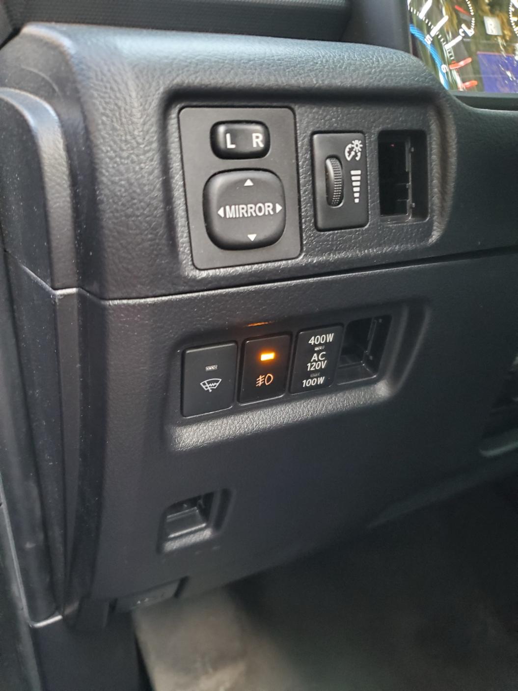

Factory look switch - but actually waiting for a REAR fog light switch so this one is temporary.

I played around with a red bulb as well. It seems to blend in with the tail lights too much. Others may just think I have a brake light out or a tail light out. So I settled for amber. At the very least it differentiates from the tail light and brake lights.

I will play around again with the red bulb but will keep it amber for now. The real test is during foggy conditions but who knows when that will come.

Well I actually came across a free cracked tail light assembly luckily from a local 5th gen FB group. I removed and cut off the reverse light socket from the harness. There are 2 wires that are attached to it. (If curious, the part number for the tail light harness is 81555-35400.) Instead of using existing reverse light socket, I removed it (still attached to harness, pushed it aside) and used the extra socket in it's spot. Then I simply ran two wires to the front. It is powered by an empty slot in the fuse box, with a fuse tap/add a circuit inline and the button wired in as well. The LED's are from VLED, I purchased an amber and a red 921 because I wanted to test both to see what I liked better.
If you don't want to look for an extra socket, you can probably achieve the same results by tapping into the Tail As Turn harness or existing harness that feeds the tail lights, most likely the tail light wire - though I am not 100% so you will need to double check and test for yourself. And if you tapped that wire, it can only be turned on when tail lights/head lights are on. Mine turn on when the key is in ACC position, not just when the headlights are on.
