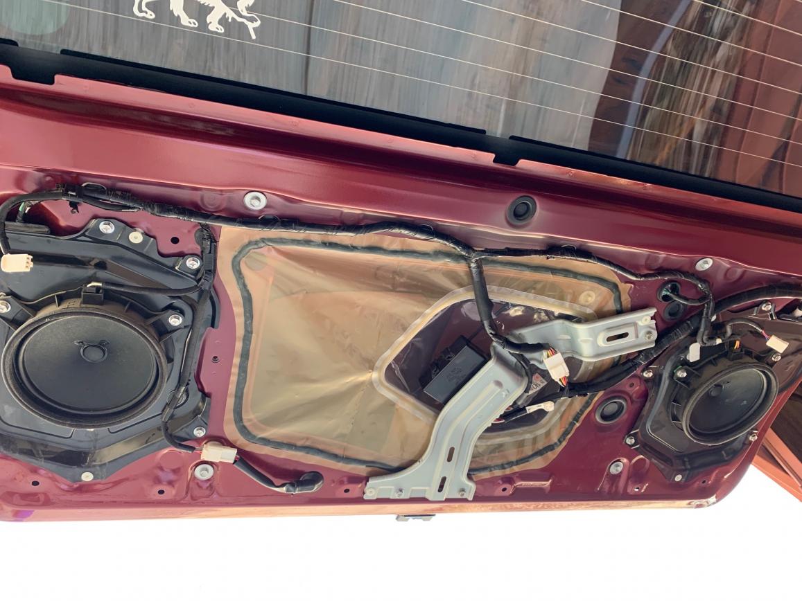

I had the same thing happen to mine. You need to remove the interior panel and pull of the plastic sheeting. It's best to pull it off fast, it will retain it's stickiness and you can reapply. There are two bolts coming through that have nuts on them. On mine one of the nuts had come off and was inside the liftgate. I put some locktite on the bolts and put the nuts back on. So far so good.

The dealer trashed mine replacing the backup camera and did a real S##T job putting it back. I bought a new one for $12 and 3M 08620 1/4" x 15' butyl tape and fixed their "warranty" work. Dumbass me didn't snap a pic before hand only after.
Also note that the retaining clips all have foam washers, in case you happen to see one lying on the ground :)
