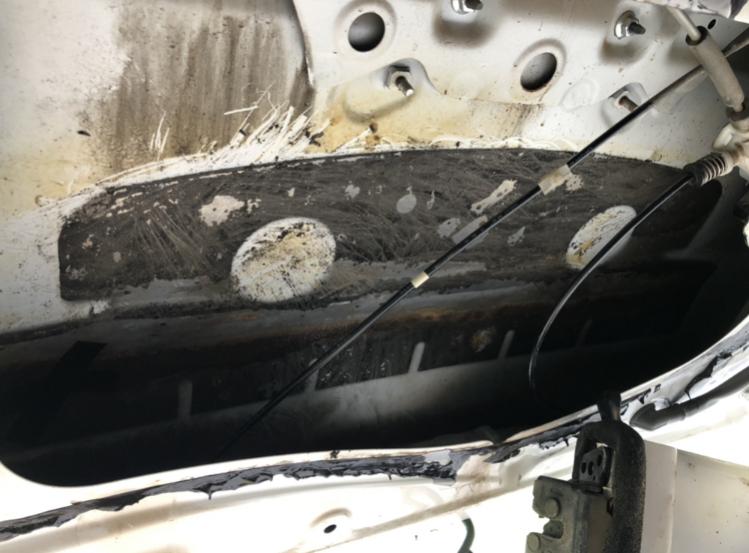

I’m in the process of scraping off the sticker and rust. The plan is to patch the small rust holes and grind the inside down to clean metal. I’ll post pictures once I’m back at my computer
This is where the hatch was rusting through, didn’t look bad till I started scraping the “sticker”...

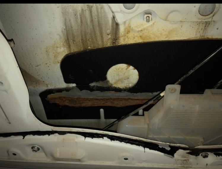

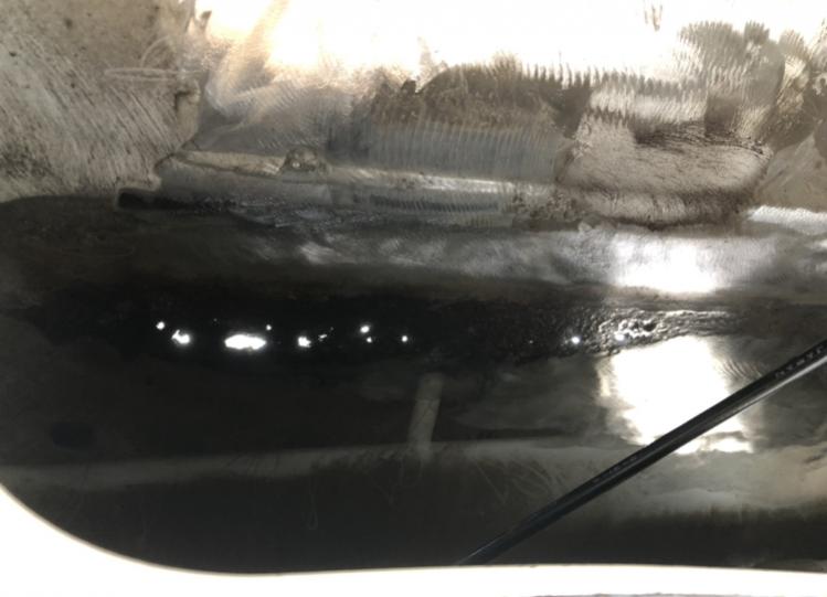

I started scraping the “sticker” with a screw driver before finishing with a flap disc on an angle grinder. Looks like I’ll have to cut out part of the metal and patch it. Damn Toyota for not painting the inside of the gate before putting the sound deadening piece on!
I can’t believe how rusted it is for a 4Runner that spent it’s entire life in a dry climate. Folks in the rust belt might want to keep an eye on their hatches!

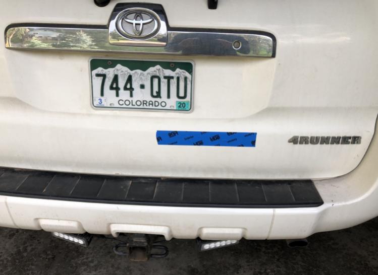

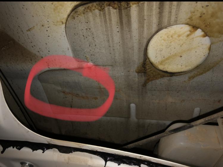

These are the bubbles or blisters on my hatch. Wondering whether there will be holes if I scrape the sticker thing and rust on the inside hatch surface. Opinions please, based on your experience?

Pull off the trim and plastic sheet that covers the inside of the hatch- its only one screw and very easy to pop the tabs with a plastic trim tool. Well worth the 5 minutes to check since its a known issue with the hatch!
Yours doesn't look too bad so maybe you caught it in time. Let us know what you find.
I already did that and everything looks fine, but another member said they got fooled the same way and found the rust only after scraping off the factory sound deadener. I plan to scrape mine but the odds of ending up with holes will dictate when I take that on. Obviously it’s impossible to precisely predict but I was hoping a few people could tell me whether theirs looked better or worse and what they found underneath the sticker thing.
