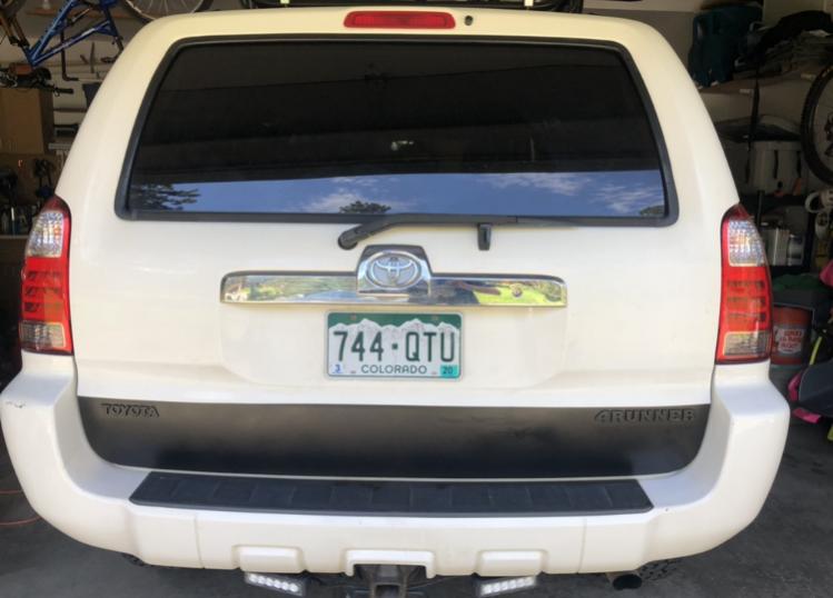

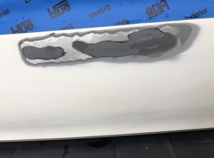

These are the bubbles or blisters on my hatch. Wondering whether there will be holes if I scrape the sticker thing and rust on the inside hatch surface. Opinions please, based on your experience?
That's EXACTLY what mine looked like when I noticed it for the first time. Boy, did I open Pandora's box. lol

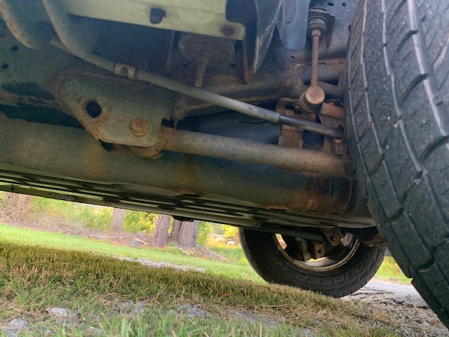

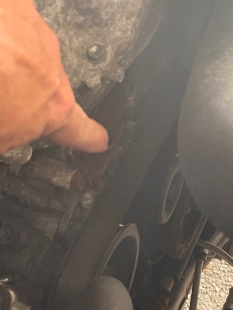

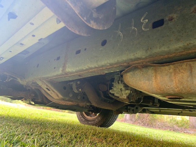

Looking into buying this 2008 4wd runner with 140,000 miles (priced at $12k). Interior is spotless and there is barely even a scratch on the outside. The only con is this car is from Pennsylvania and the car is rusted. These pictures aren't great, but does this look like I might be able to drive this vehicle for 4+ years or will the rust be too much of a hassle in the long run.

That frame looks way better than mine did when I got it. That one is still able to be saved inmo. I would definitely plan to spend the time wire wheeling, or sandblasting it, then priming and painting to make it last though. Also, flush out the inside of the frame and coat with internal frame coating like the Eastwood stuff, or something like fluid film because trapped salt can (and will) rust its way through from the inside out.
The frame looks OK, but the bolts look like they will be a pain to work on. My dad’s truck came from the northeast and it gives my impact wrench a good test whenever we work on it. Also look at the radiator cross member, those tend to rust out.

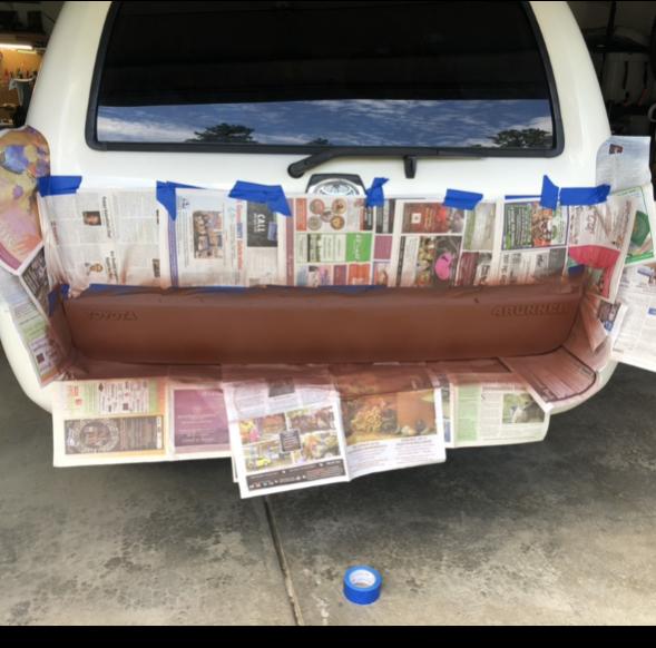

The JB Weld patch turned out better than expected and the bed liner covered it up perfectly. The plan was to paint the bedliner with color matched spray paint, but I might leave it black for a while. Has anyone used Rustoleum bed liner? Does it turn chalky right away?

i agree with other person - that rust doesnt look bad for east coast (MA here) standards. I want to say it looks similar or just a tad worse than mine was when i got it...after looking at 4 others. ironically one of them looked like that one, same color, great shape on outside, but literally the entire underside was rusted and I walked away. the salesman made a gesture to another employee that the car was going to be tough to get rid of for them.
