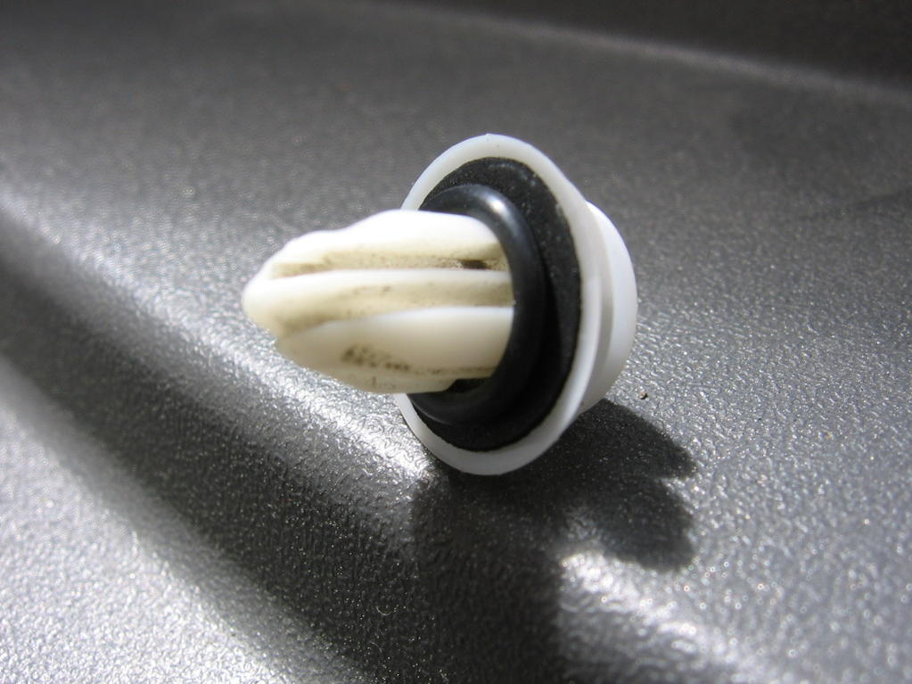

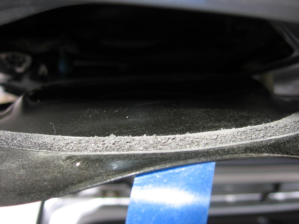

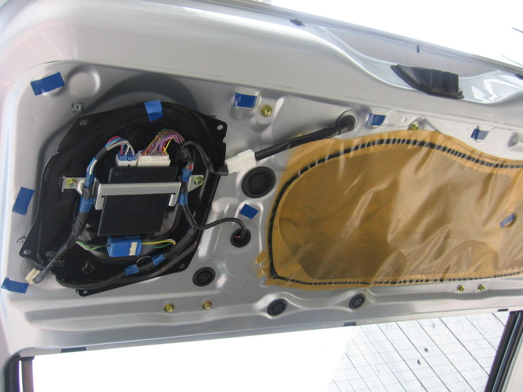

Thanks for the info everyone. I have attempted the same fix; I really hope it works out. Here are some photos of the inside of the tailgate with the cover removed. In the first photo, the black electrical unit where the water was leaking from is at the very left.
The very bottom photo shows a closeup of the foam gasket around the electrical unit where the water was most likely coming from, as there was a dirt trail which I cleaned up before I took the photo. (notice how the bottom of the gasket is a bit degraded) I cleaned that part of the gasket with a brass bristle brush a bit and put the silicone all over the bottom quarter of the gasket quite and then bolted it back on. Not super tight as there is plastic involved. Hope it still comes off if I ever need to service it. That's why I only did the bottom quarter. Plus I didn't take off the whole assembly because it would have involved removing the wiring harness. So I could only access the bottom quarter anyway.
The closeup of the trim fastener shows a small o-ring I put on as there was water coming out of the bottom left one. The o-ring is too thick though. A thinner one would have been better as it doesn't allow the fastener to go into the metal all the way.
All the blue tape you see is where the trim fastener holes are. I was so I could do a leak test but it never rained! (I covered all the trim fastener holes so I could sit in there when it rained without the cover on and confirm the water entry. Anyway, everything is re-assembled and I really hope this works out. I will follow up with a post.
***update***
There was a monsoon and no water came in; hope the repair continues to hold. Thanks everyone!
***update***
