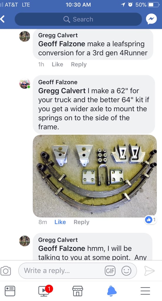

Not sure how many of you know who Geoff is but he owns Giant motorsports in Southern California and does a lot of leaf spring conversion stuff for desert trucks and prerunners. The picture he posted is his 64” kit that mounts to the side of the frame rail but I asked for a 62” spring kit picture.
I may go this route when I get a chance. I know Geoff personally and also know the ppl at deaver well enough to go that route as well. I’d run 62” spring kit I think vs the side mount 64” spring kit
