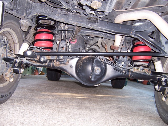

As the proper red neck that I am I run the OME 3in spring and kept my coil spacer. Just to give it that south of the border look.
I also run the OME rear coils and added Airlift assist bags inside them. I talked with Airlift and they sent me bags that were 3" taller but the same diameter as stock. I cut off the upper rubber bumper cone at the first segment. This gives the bag a full size circle to rest on at the top.
Used it pulling my offroad trailer last weekend and it worked great.
With the bumper cone not cut down, aren't you concerned about the small contact area at the top of the air bag possibly causing a rupture under pressure?:awais:
