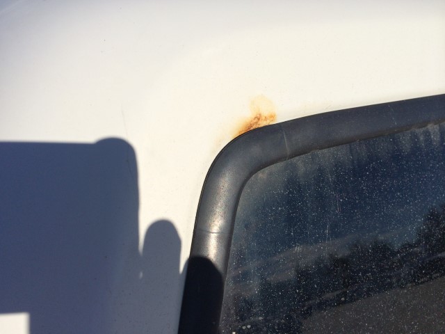

I have a 2008, and I have a rust bubble behind my rear windshield wiper. I brought it to the dealer and showed them, they had a Toyota Rep look at it who says there is a "chip" in the paint where the rust has formed. Really???!?!? On the rear liftgate?? I *****ed and moaned, and the dealership is now "covering" it. There obviously is a problem with these liftgates rusting in a less than average time period, its too bad Toyota wont acknowledge it.

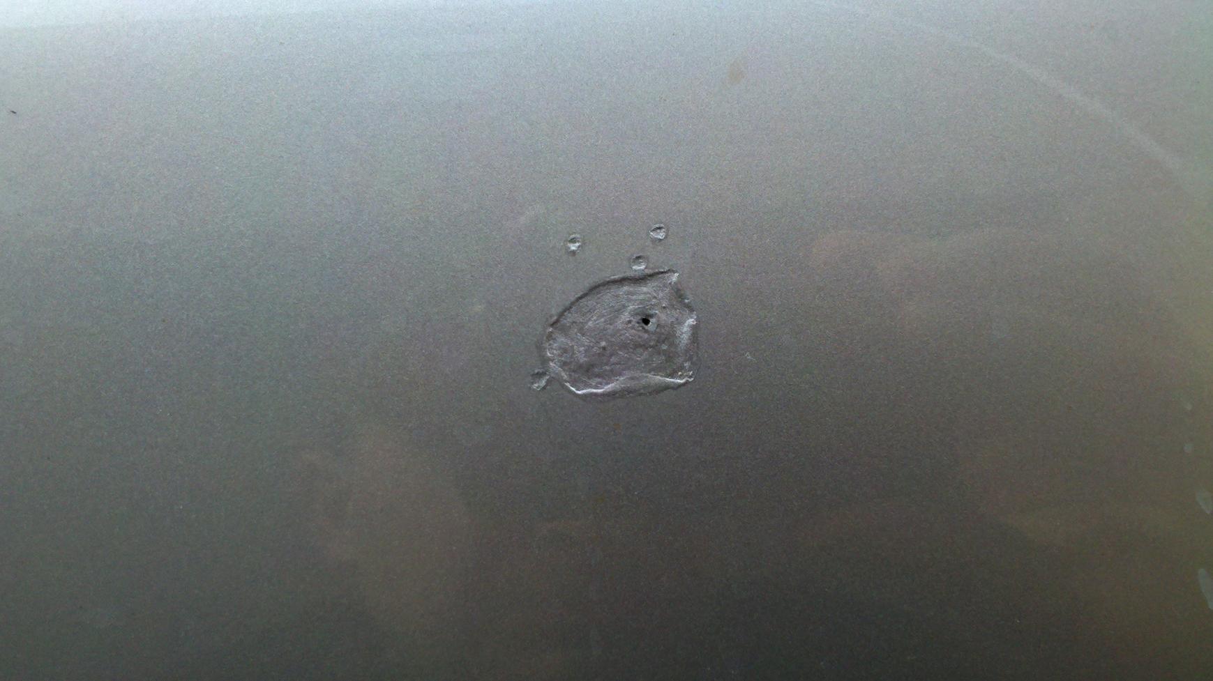

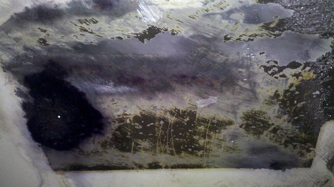

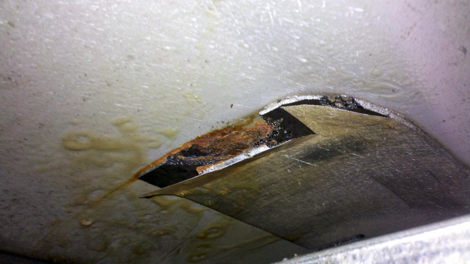

I have 2007 SE and since i bought it 2 years ago I have a problem with the liftgate rust bubbles.As you can see on the second picture rust came from the inside .What is the purpuse of that plastic-rubber attached to the inside of the backdoor? It seems that rust is forming right under that plastic.Yellow stuff around the area is just a Fluidfilm wich I used a year ago.Do you guys know better corrosion protective product that I can use? For now I just cleaned and sprayed the aera with the rust converter.Then I used body filler to cover the hole and painted with the touch-up paint. I hope that will be enough untill spring will come.
Have you taken it to Toyota? Toyota's warranty covers rust through perforations, not surface rust.

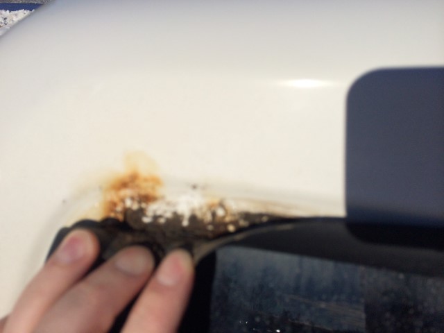

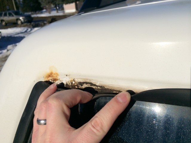

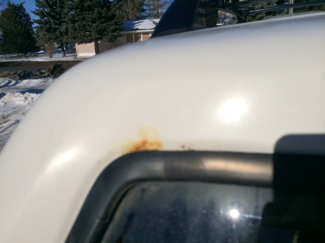

Not sure if anyone is still paying attention to this thread, but I've got a 2008 rust bubble on top left run channel. I plan on removing the weatherstripping and grinding out the rust bubble and painting over it. It doesn't seem hollow yet so I may have caught it before it was too bad, guess I'll see when I grind it down.
Should I get new run channel weatherstripping? The current one seems like it's in decent condition. Clean it out and put the old one back on? Seal the weatherstripping with something? Clean it out a few times a year? I saw boeshield reference in another thread, maybe I can seal it with that. I think the previous owner must have parked it outside all the time or something.
In the pics you can see all the gunk run the whole perimeter of the window.
I've got a hump spoiler ready to go on so maybe that will help direct gunk over the window instead of in the weatherstripping.
