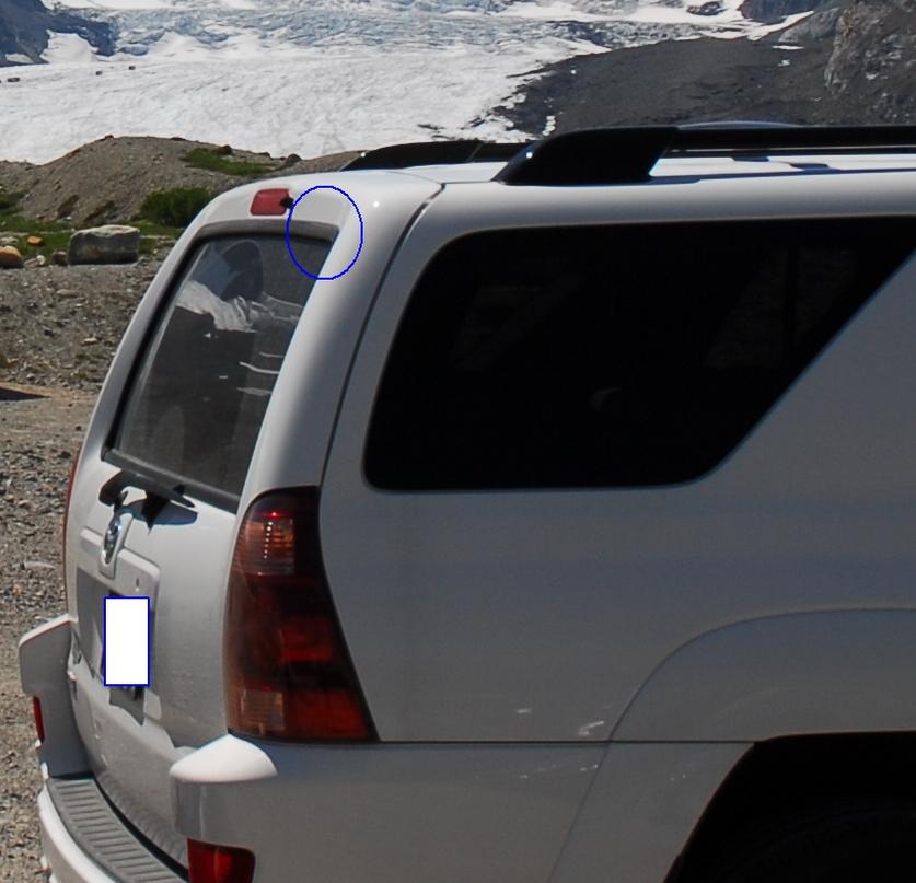

Someone have a pic with the affected areas? Even a post-repair pic with an arrow or two editted into it would be great. Thanks.

I'll be removing my weather stripping and cleaning all the dirt and muck out in the next few days. I'll try and snap a few photos while I'm in there. Luckily, mine isn't too bad yet.
Here is a picture of the most affected area on my truck. This was before the repairs, but to see the rust at that time you had to bend the rubber back.

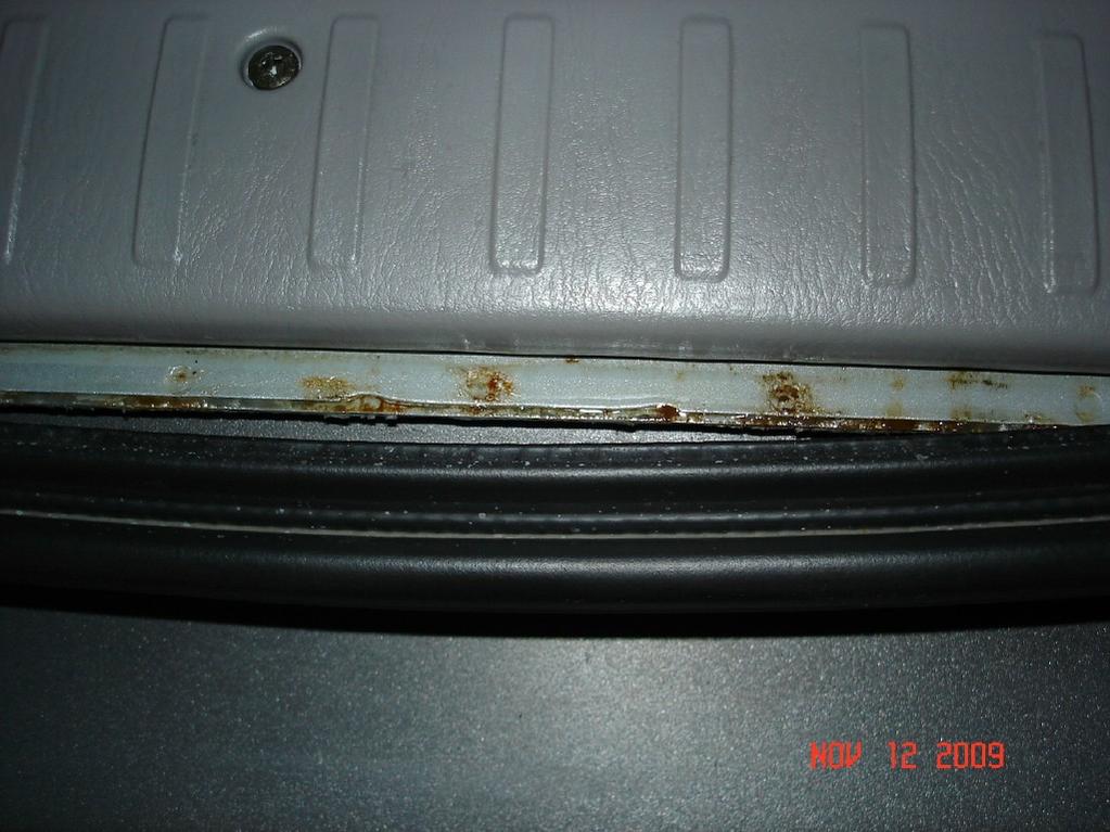

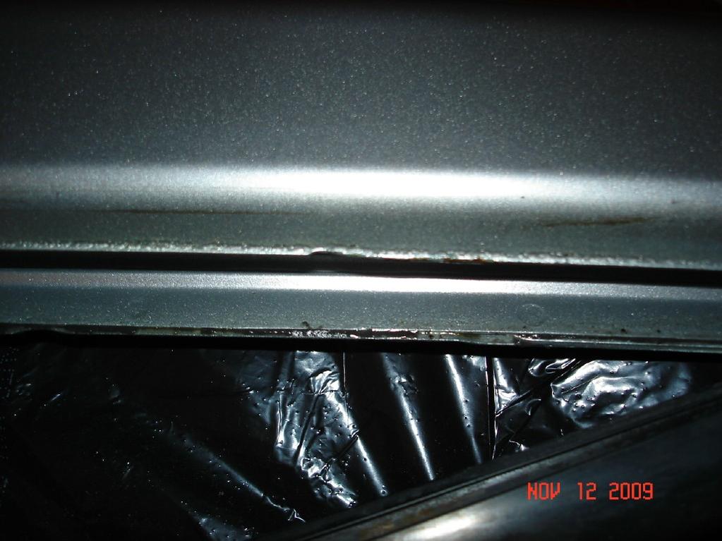

Well guys, I decided to start tackling the truck rust last night. Come to find out, the top of my truck by the 3rd brake light wasn't too rusty. The bottom portion fo the truck, above the bumper, is a whole different story all together.
So what I did was:
1) Lower the window
2) Tape up plastic 40 gallon garbage bags over rear lift gate and going into the inside of the truck. This will keep the dirt out when you pull the trim. Use the blue painters tape for this, so nothing sticks to the truck.
3) Pull the trim down and off the truck.
4) Clean the metal area that is rusted. Get all the dirt off. Alcohol is great for cleaning these painted areas.
5) I personally chose a different route. I did not prime or sand my rust. I instead have used a product called Boeshield to penetrate the rust, stop it and form a waxy protection layer going forward. This way, water will be repelled.
6) Make sure to clean all the dirt and grime out of the U-Channel on the top molding around the window. The dirt in there is absolutely unreal. No wonder there are issues.
7) Let the Boeshield penetrate and dry for a day or two, if you can.
When I re-assemble, I'm going to put more Boeshield in the U-Channel and let it set up for a day or two. It's great stuff, stops rust and is safe for painted surfaces.
Enjoy the pics below of my rust. It's pretty sad but my guess is any 03 or 04 will have the same issues by now.

Thanks for the tips and pictures. I understand the location of the second picture in your post - but I am confused about the orientation of the first picture. Is it the top of the window with the weatherstripping removed?
Yes, that is the top of the window with the molding removed and the window down. The black backdrop is the plastic bag backing I used.
One note of caution. I re-assembled the truck today and cleaning the black molding out kind of stretched it out a bit. I've got blue painters tape adhered between the molding and truck paint (around the 3rd brake area) to see if I can't get the molding to conform a bit more. Worst case, I may use some black RTV silicone and run a bead the length of the molding. This may also help with further water penetration in that area.
