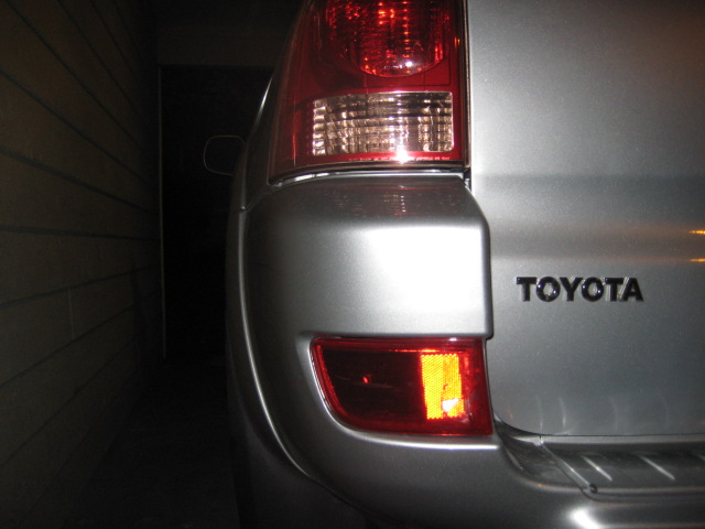

Hi All,
I'm new to the forum. I just bought an '03 4Runner and I'm loving it so far. :) I need to replace the broken bottom rear light/reflector on the driver side, but I'm not sure how to tackle it. I don't think it pulls straight out. I haven't really had the chance to dive into it, but can anybody give advice on how to take it out and replace it? I've included a picture to show the light I'm talking about. Thanks for any advice!

Check out this thread. http://www.toyota-4runner.org/showthread.php?s=&threadid=1137
That picture doesn't look like it's broken....:confused:
EDIT: I see where it's cracked! Gotcha
there is a single 10mm nut that you must remove and it will snap right out. I looked up under there and used a socket to remove it. Took a few seconds and it was out. The drivers side is the easiest of the two. Look up under there you will see what I am talking about.
I just did the light mod and turned both of mine into working lights Turn/stop/parking etc.
it has quite a bit of relatine info here as well http://www.toyota-4runner.org/showthread.php?s=&threadid=1137
