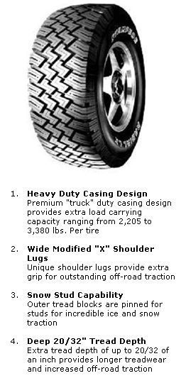

Thanks for the advice.
My current tires are 30x9.50 Mesa CT's. They are a deep lug, offroad/utility tire available at Big'O. I really like them, they wear great, just wish I would have gone with 33x10.50's(http://www.bigotires.com/TireDetails.aspx?Category=12CAD0V&PartNo=MCT78)
My thought process was that with a locker in the front, in snow-covered road conditions, I could keep it in 2WD and not have the locker affect the driving (or maybe even lock one hub for 3WD!)
It does seem that the overwhelming majority suggest locking the rear, then the front if needed.
I am considering buying a spare 4cyl rear 3rd member to either weld, or install a locker into,...then lock the front later.
