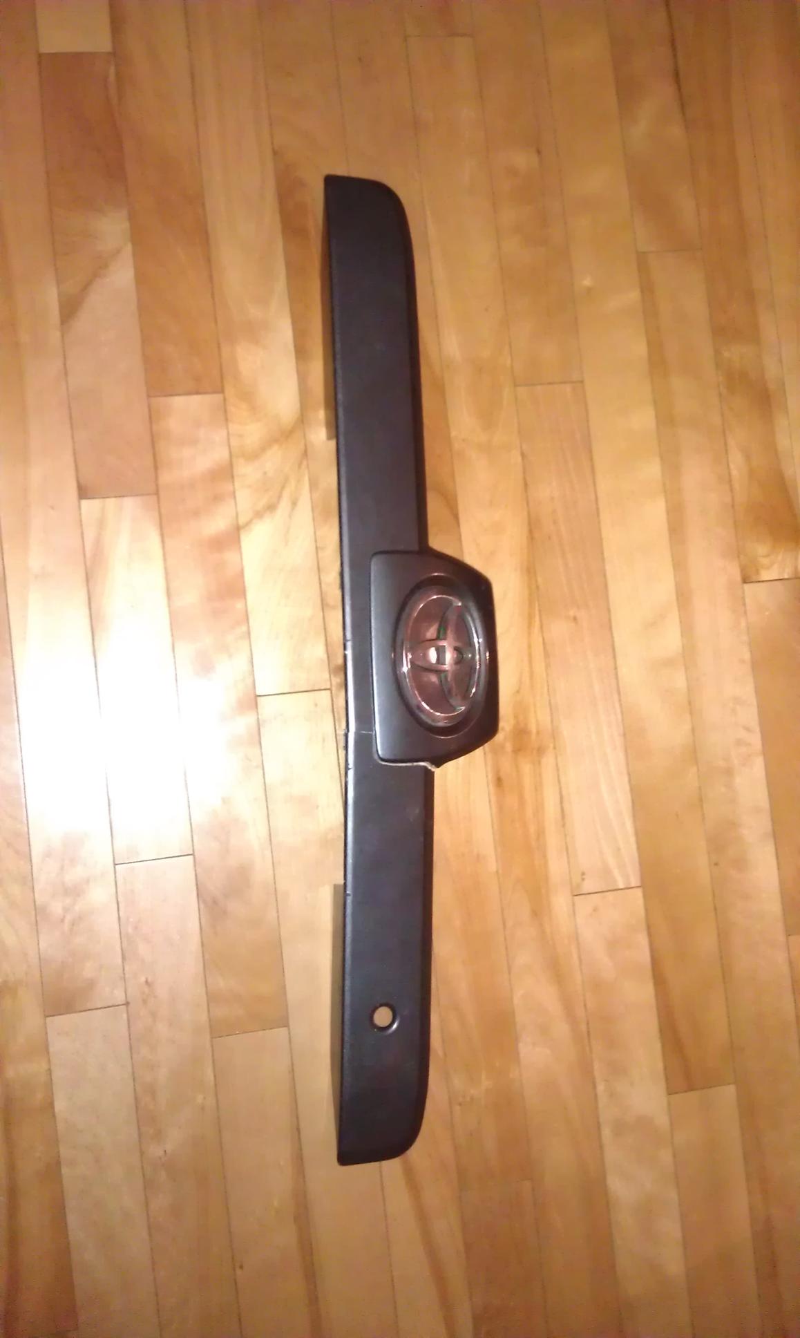

I accidentally hit the garage door early this evening and broke the trim that holds the the logo. I just took the whole part off and was wondering if I can fix this myself. My 4runner is 2005 v8.
Will anyone please tell me where I can order that part? Is it possible that i can replace that part myself. Any suggestions?
I am new to this form and this is my first post. Thanks very much in advance for any help.

Try Sunnyside Toyota in Cleveland,ask for Gary in parts.He sells at wholesale prices and has always given me a better price than any other dealer.
Cost is $140 new and you can do it yourself. I can't make out the color of the handle; what's the color of your vehicle?
Conicelli is cheap, but Camelback Toyota, Phoenix is cheaper yet (but in AZ you get hit with tax).

Thanks all... anyone knows how to find the color code of my runner? I didn't find it on owners manual.
Is there way to find this out myself with the VIN or auto code?
Sorry for many silly posts? I found the colour is Galactic Gray Mica (1E9). Is this the color of Dark Gray?
1E9 is Galactic Gray Mica or Dark Grey (handle).
The part number for the handle is 76801-35380-B1. (Edit: This is the part number for the vehicle w/o rear monitor.)
Conicelli has it for $151 shipped. CamelBack Toyota has it for $140 shipped.

Hi,
do you by chance know the part number for the unpainted handle (that matches the textured bumpers)?
