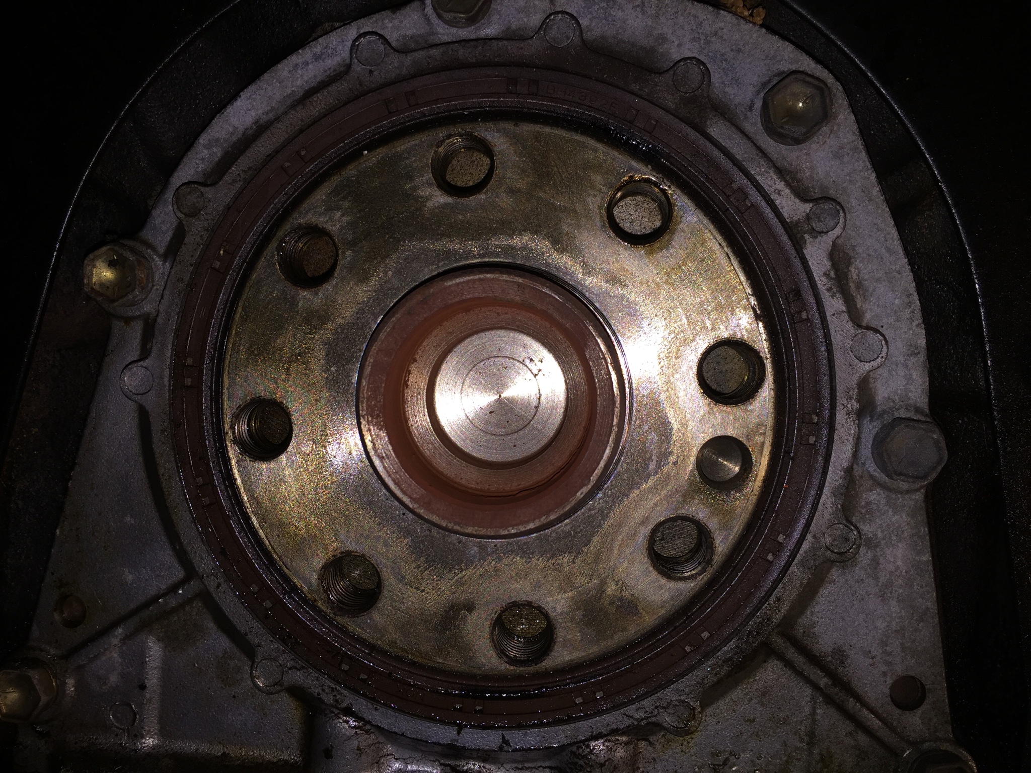

This is what's in there now. Don't know if it's factory or not being brown.

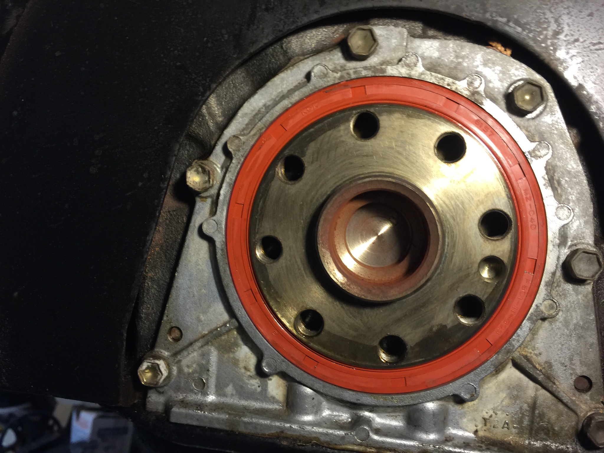

This went in fairly easy. Lubed the inner grove and tapped it in until it bottomed out.
This is a Napa SKF
