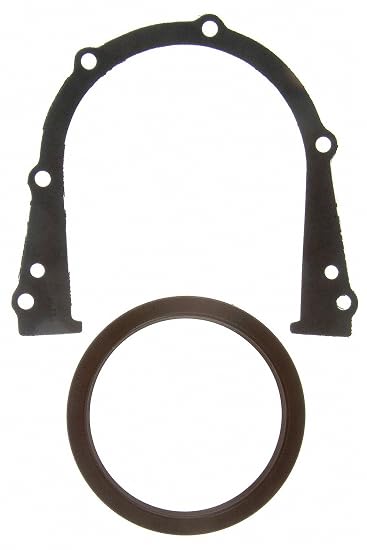

I ordered a Fel-Pro gasket from Amazon, and it comes with a gasket:
When I removed my rear main today I noticed there is no gasket. My Haynes manual makes no reference to using a gasket, just RTV gasket maker (which I purchased and have on hand).
Question: Should I just discard the gasket? Or is this some improvement on the stock implementation?
I used a Victor Reinz rear main seal which came with a paper gasket. I threw away the gasket and just used RTV. RTV seals better against surface imperfections and remains more pliable over time whereas some gaskets get old and crusty. Also with the rear main, you'll have to use RTV on the bottom edge contacting the oil pan anyways.

My own research on this revealed a significant number of thread where folks experienced leaks within days of installing non-OEM (several Fel-Pro) gaskets.:fear:
The transmission pull and clutch removal is such a PITA, I have decided to wait for the dealer to open tomorrow and pick up a Toyota OEM rear main seal.
It's just not worth the anxiety and (added) potential for failure when I'm doing it myself.
