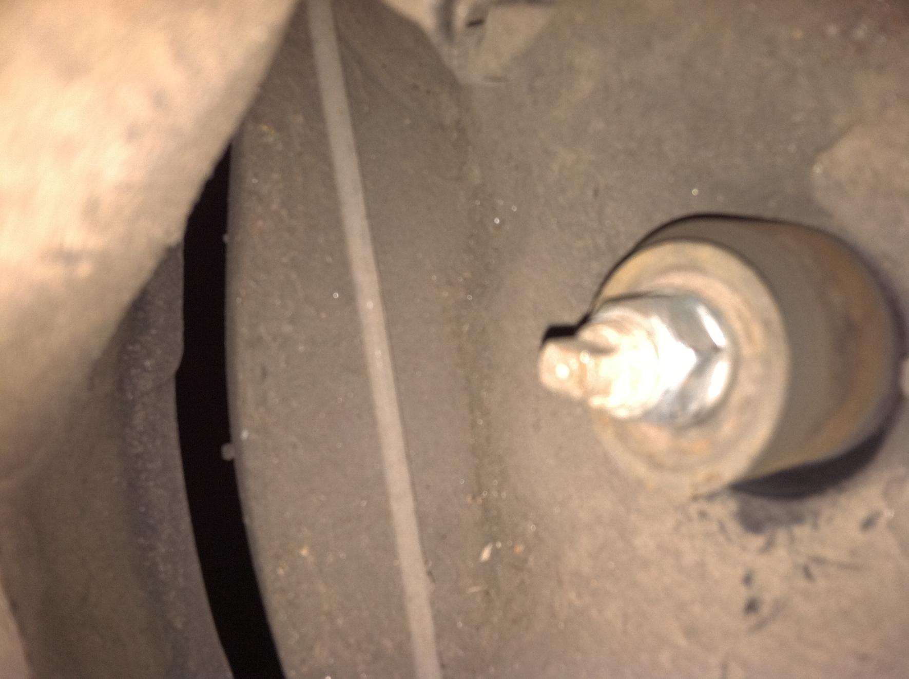

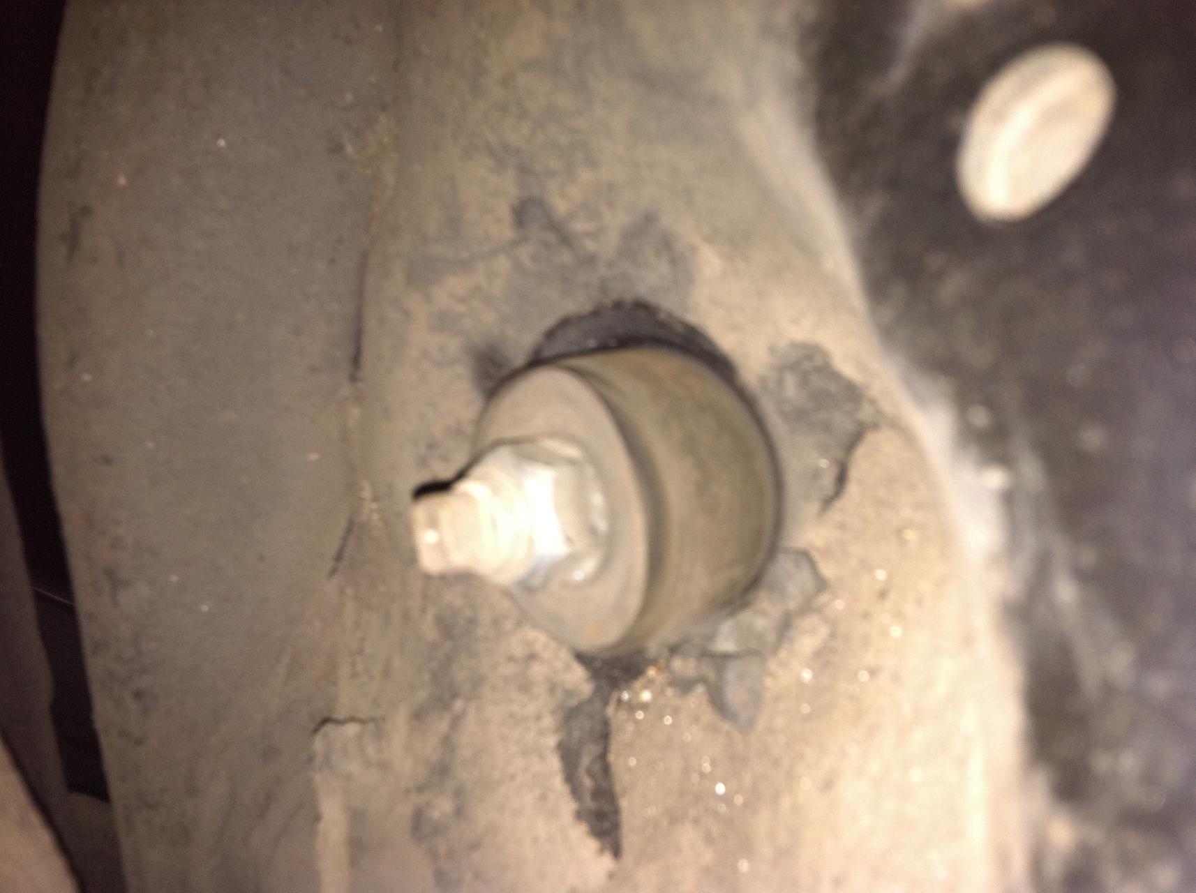

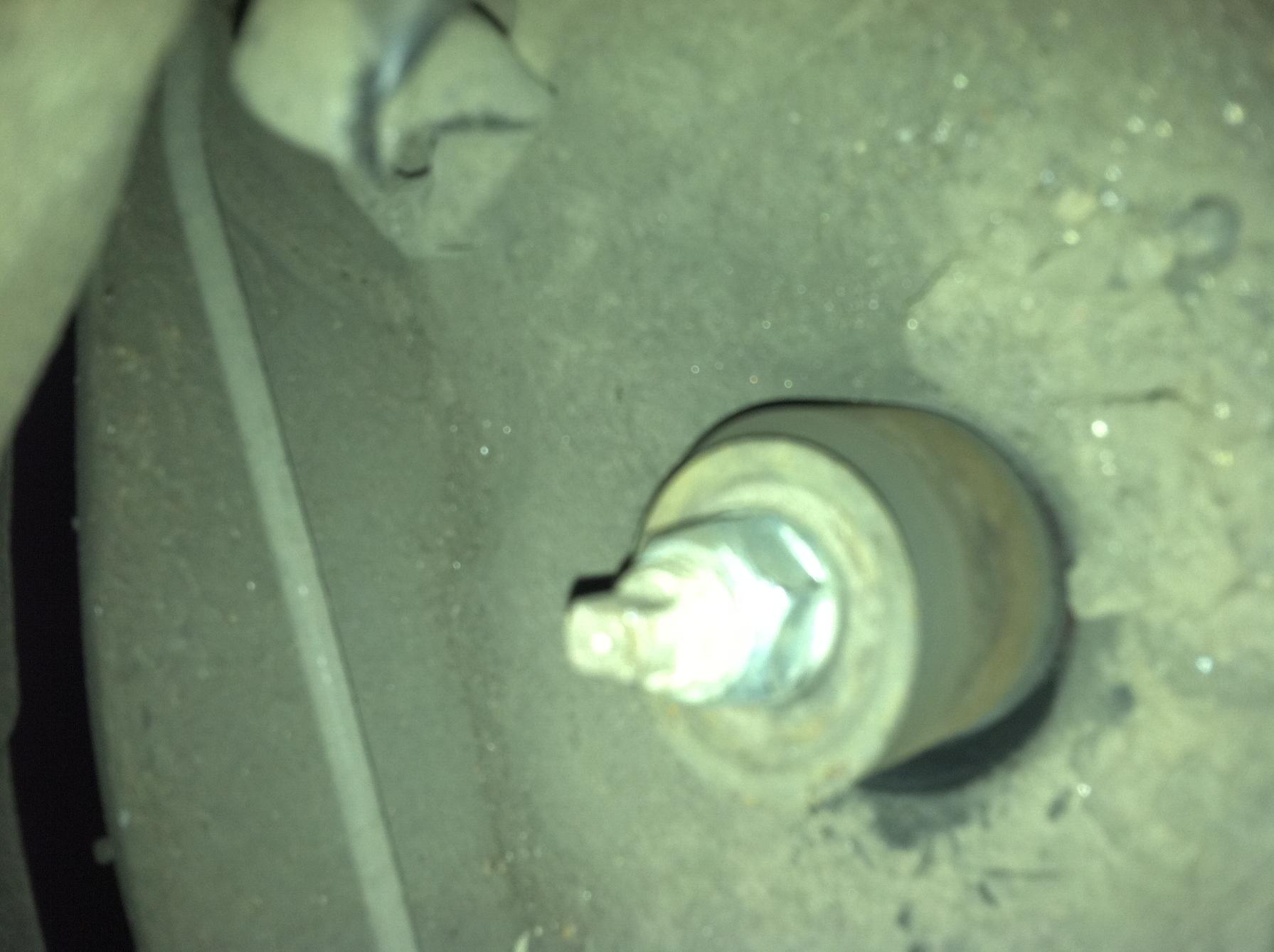

Well they've got the big rubber bushings on each side of the mount and those seemed pretty compressed, almost squished but its still loose. I took some pics but not sure what all you can tell from them
Sorry for the big pics. Damn iPhone
those things are way too lose, that rubber grommet at the top isnt hardly squashed down at all! you should have like at least a half inch of threads on that stud showing
and you notice how on the top of that stud its been "squared" or rectangled" off...? yeah use and adjustable/crescent or fitted open ended wrench on that a ratcheting wrench(closed end) on the nut, that will keep your shock from twisting as you tighten it down.
