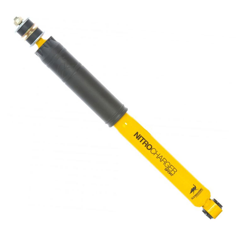

So I've installed the old man emu rear 890 coils and 60073 soft shocks. The problem is that I am having a hell of a time tightening the shock top nut, when ever I spin the nut, I spin the top half of the shock along with it. Same type of problem most people have including my self when removing the old shocks, but in reverse. The major issue is there is a plastic shroud over the top half of the shock so I can't hold it while I spin the nut, nor can I get a pipe wrench over it.

see thats exactly what I was trying to do... but the top half of the shock is entirely covered with a black plastic shroud that spins over the shock. So holding this plastic does not help keep the shock still.

See the black plastic shroud? It prevents me from holding the top of the shock...

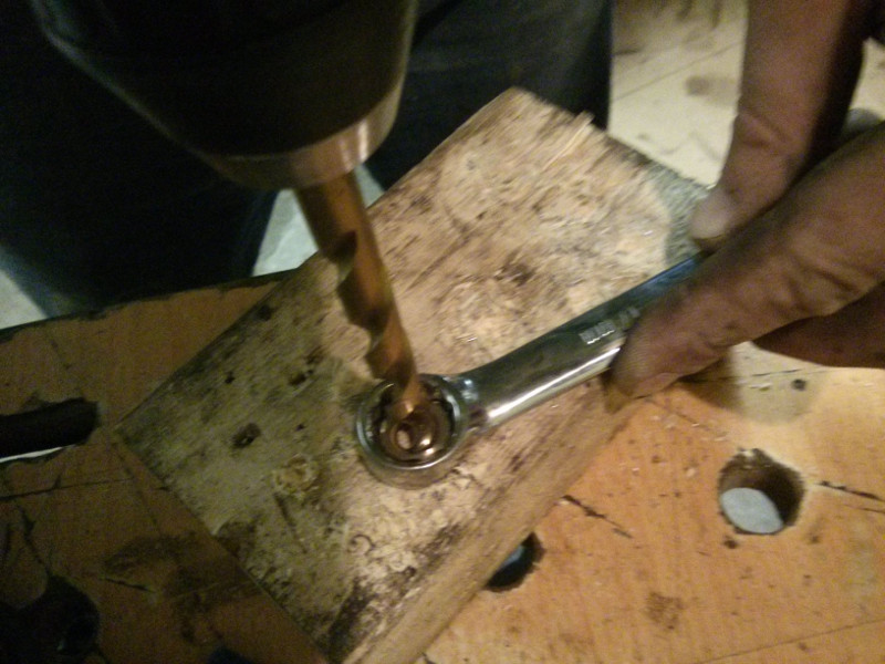

I figured I should probably share my solution with the rest of the forums though. My solution was to order 2x 17mm jam nuts, M10x1.25 (from fastenal.com), drill out the threads then smash them onto the upper shock mount stud.
First drill out the threads of the jam nut to make it easier to smash the nut down the shaft:

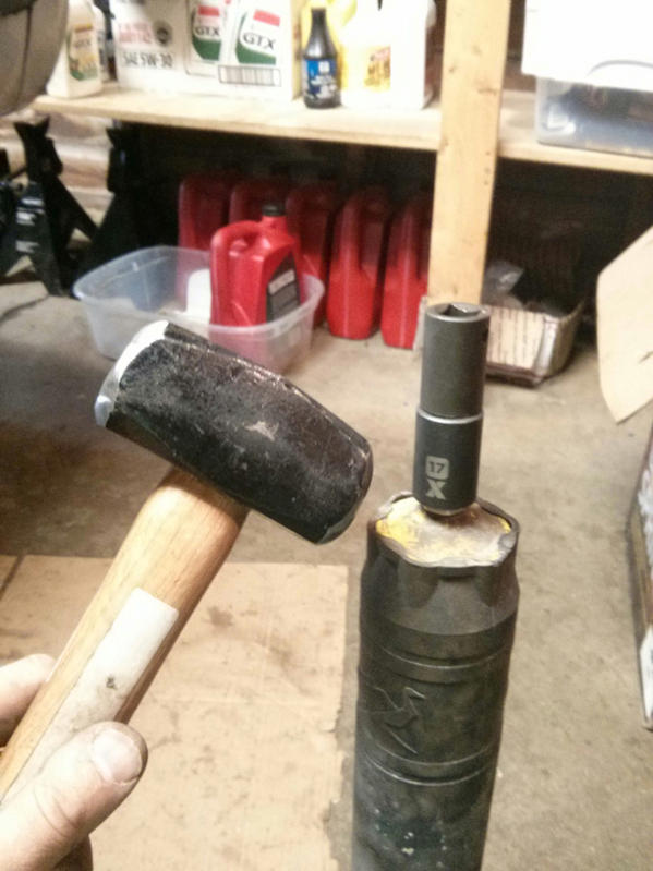

Next step is to thread the jam nut all the way to the bottom of the upper shock mount stud. When its at the end of the threads it should be spinning because the threads on the nut are basically gone. Then use a 1/2" drive socket to smash the nut all the way to the bottom of the stud.
attachment.php
As you smash the nut on to the stud it'll compress the shock and eventually you'll get a few solid whacks. I don't think this is a problem compressing the shock like this but I'd love your feed back.

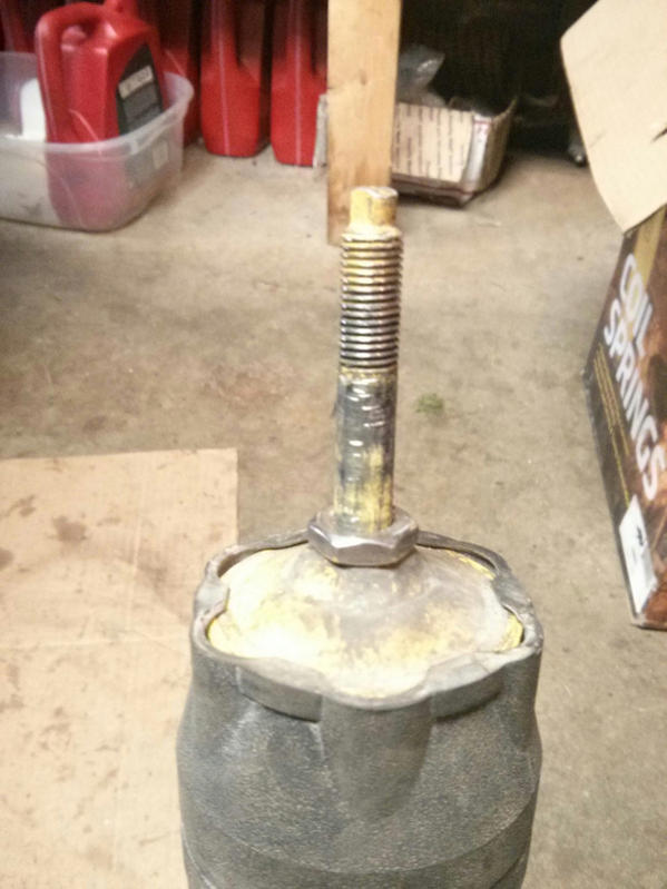

attachment.php
Once you have that jam nut smashed all the way to the bottom of the shock you can go a head and reinstall it onto the rear end of the vehicle. The trick now is that you can take a pair of locking pliers (or if you have a thin enough 17mm wrench) and put them on the jam nut. There is so much friction from the smashing that the nut is not going to spin with the 20 ft-lbs required to torque down the bolts. If your a super pro and you've got a welder Id suggest tack welding the nut to the stud. But I'm not a super pro and don't have a welder sooo...
