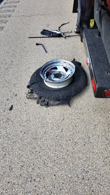

If the sound the OP is hearing grows faster with speed, my hunch would be on a tire. I've heard a lot of them make that sound as they go down the road. It will just get worse and eventually separate. It will either unroll or explode. I had one explode. :-(
