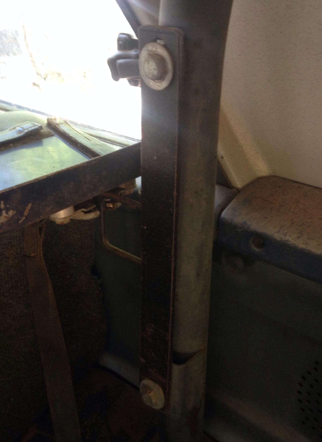

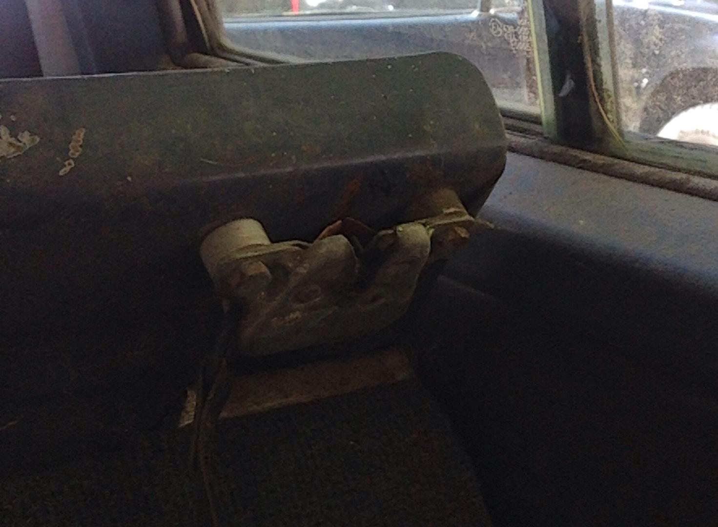

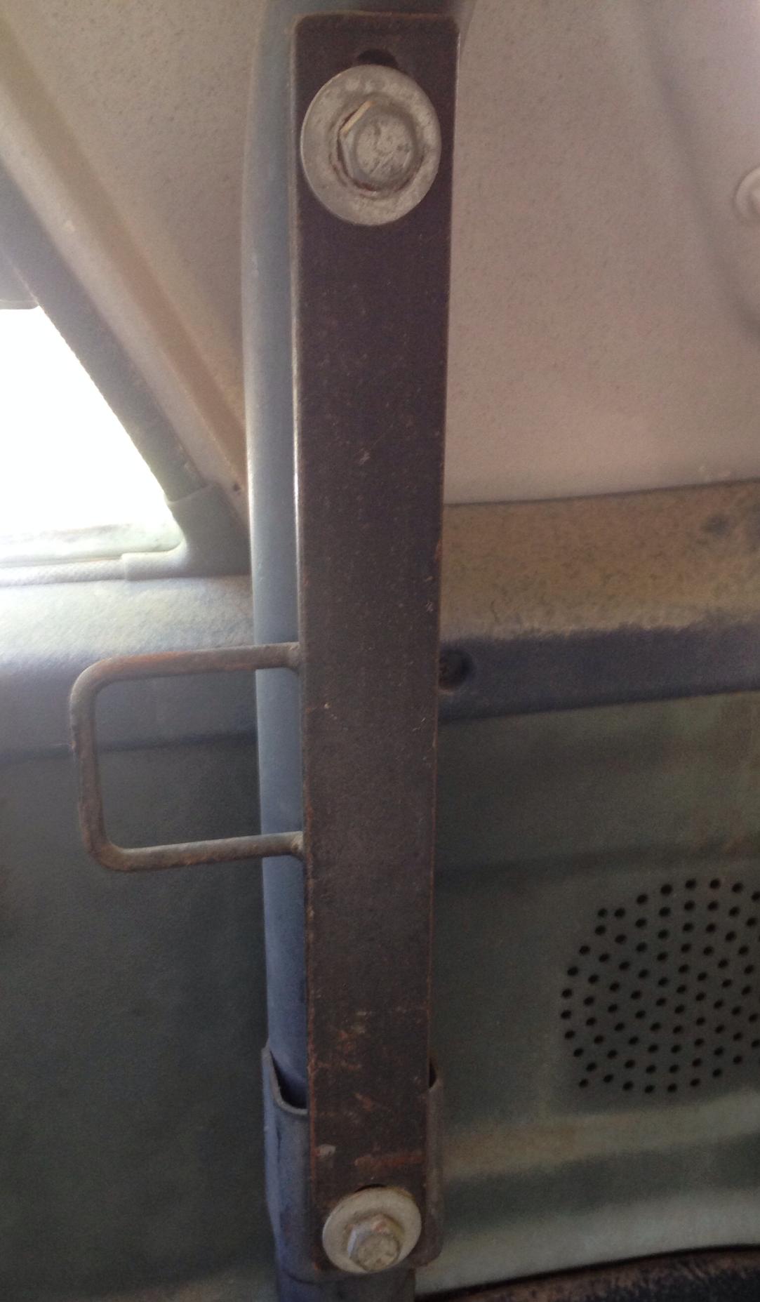

Here's a couple pics. The hinge on the back is just a piano type hinge the whole width of the seat. There is no sign of a spot to put the catches in the side panel but I looked in my 95 and see that's how that one is. I believe with a little modding I may be able to put a second gen setup in my truck. image.jpg

Behind your plastic panels, you should find these mounting points for the latch. Not that you need to use those since yours probably work just fine. Just want to point out that they're probably back behind the plastic panel in case you want to swap in stock rear seats, these points should be there for you to latch to.
I leaned the seat a bit so you could see how far forward of the roll bar the stock latch goes.
I would think you could put the belt retractor and shoulder clip on your roll bar, even with your seat latch there. The bar you have attached only looks like 1/4" thick or so. You can easily fit the retractor and shoulder clip over the bar. Just use the new seat belt bolts to attach it all.
