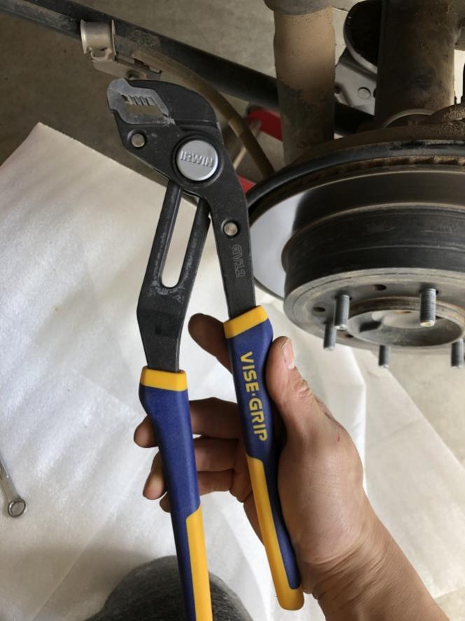

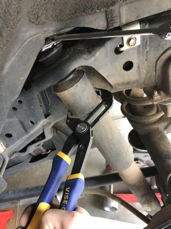

I just found this thread because whatever I tried gripping the top part, it kept slipping, and then tried THIS:
Works like a charm.
