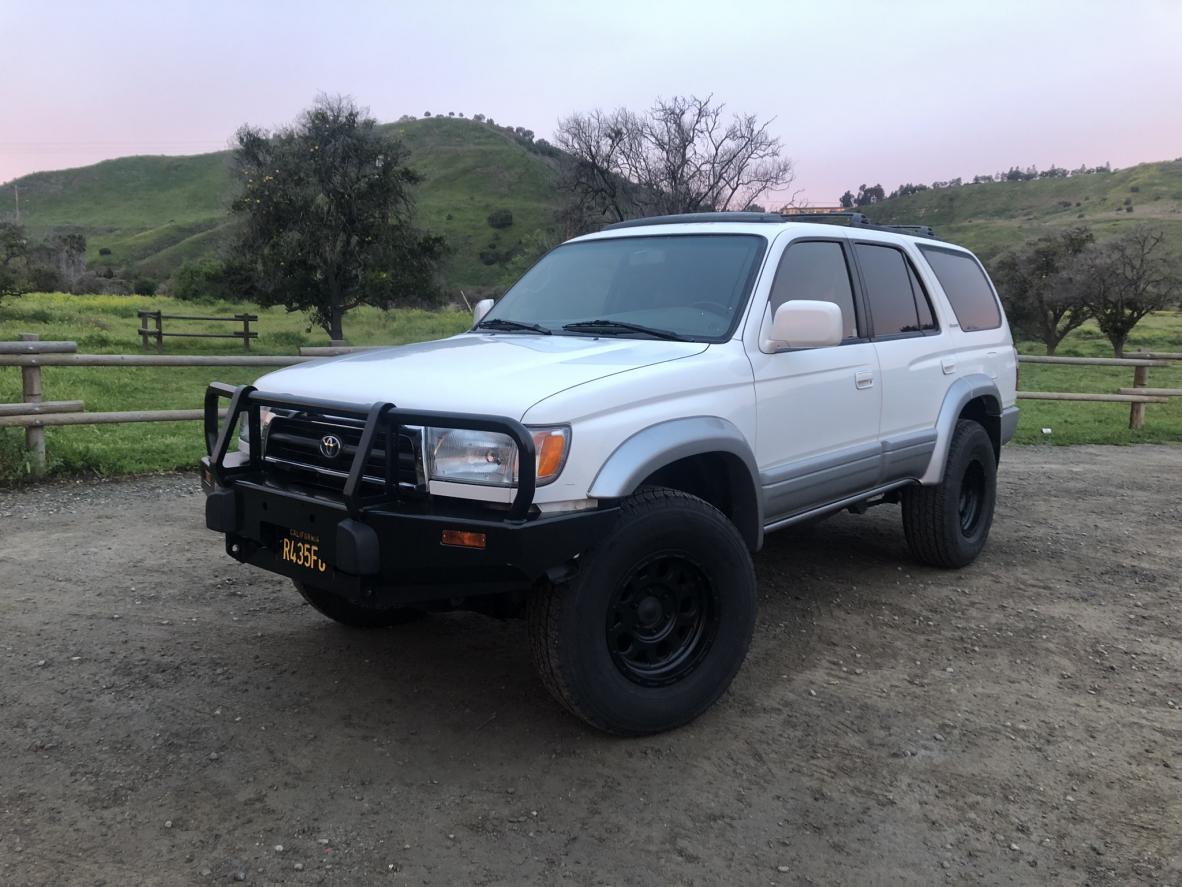

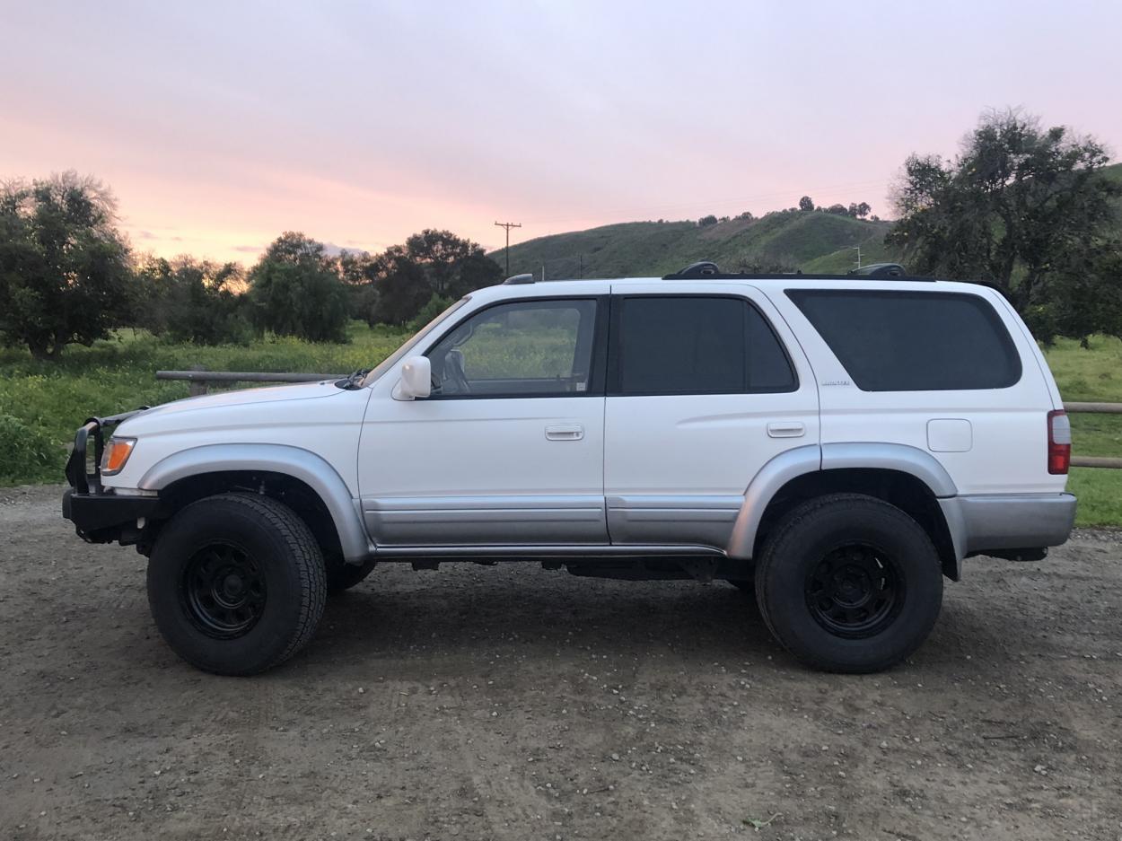

Update, post intall
An update. Sadly, I do not have a matching before/after profile comparison. Nor did I take any proper measurements before I installed the new components. Doh. I just knew that the 4Runner didn't look or ride it's best after I bought it a few weeks ago.
Here we are, now sitting with the following new suspension setup.
Front:
Bilstein 6112, set to #6/4
Rear:
Bilstein 5160 B8
Eibach 1" Pro Lift springs (E30-82-006-05-02)
I am very pleased with the outcome stance wise. I wanted an ever so tiny but or rake, and a tasteful lift. I think it turned out ok. The ride quality is excellent on road. Haven't had a chance to get dirty yet...
