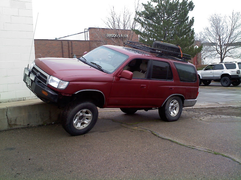

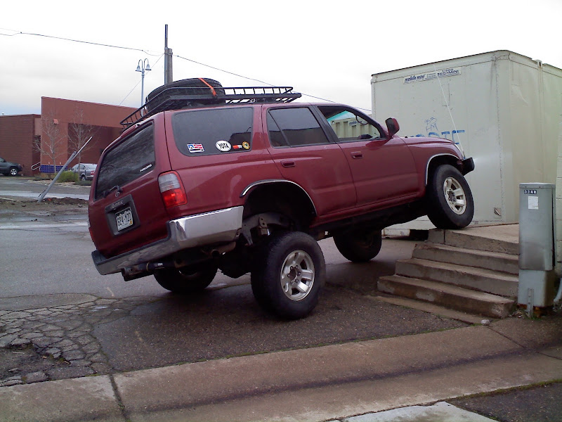

I'm not sure why your #s are so far off mine. Maybe because mine are the OME comfort shocks instead of the sports?? I'm getting several inches of down travel. Then I removed my sway bars and now it's enough to fully stuff the tire on the other side (meaning it couldn't go up any farther even if the shock would allow it). Steeze, do you know why I don't seem to be limited in my travel?
These pics are with the swaybar still on. Now I have about another 1" of travel on top of this.
