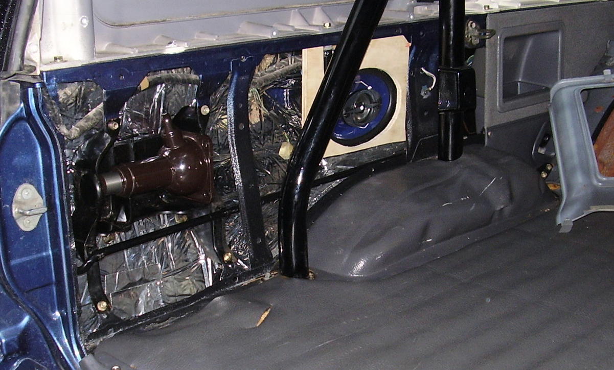

I made a set to hold 6x9 speakers out of 1/2 plywood.

I plan on making plywood panels in place of the plastic ones and cut out places for 6x9 speakers. You could add a piece of plywood to the back of the plastic panel to make it rigid and cut a hole to mount your 6.5 speaker. You would probably also want a grill or your speakers so they don't get damaged.

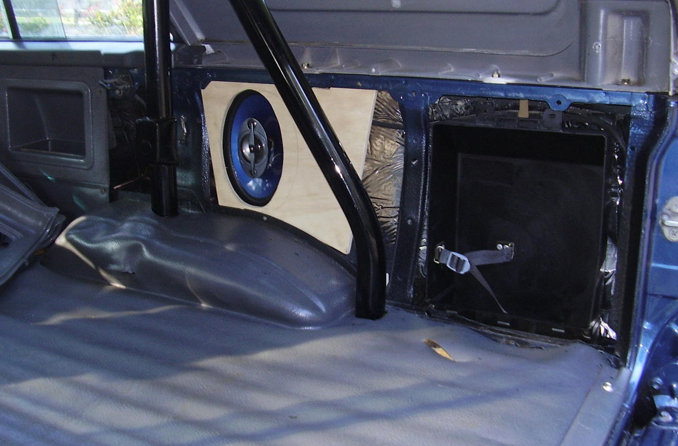

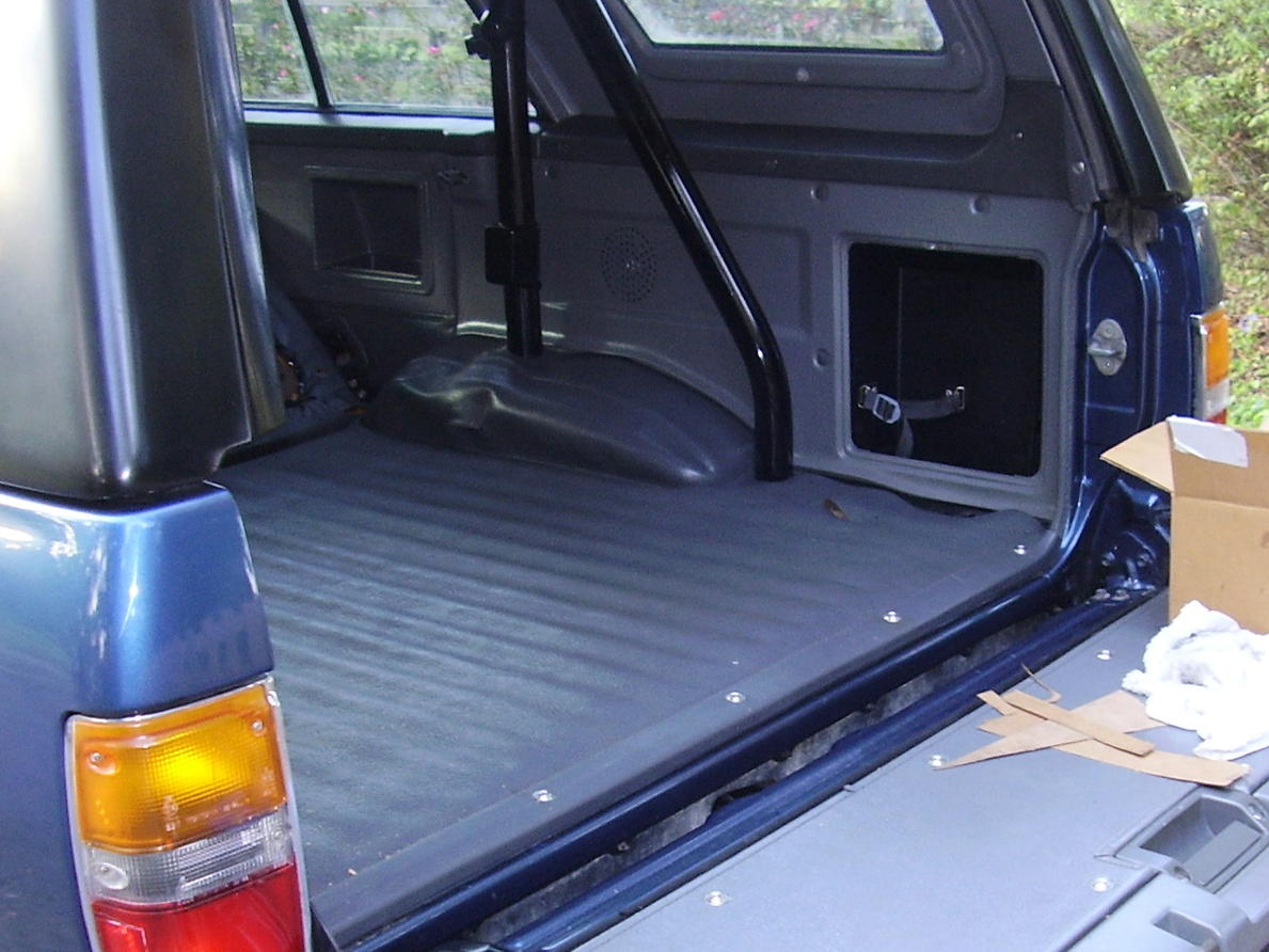

Here is a few shots of my speaker job

Unless you are going to use 4" speakers, you cannot use the factory brackets. The factory speaker is an amplified, 5" speaker that has the tweeter integrated into the bracket assembly. You need to cut that out to get it work. Your best bet is as everyone has stated, pretty much make one yourself to go behind the panel or find one that will contour to the panel. I provide the following evidence :nerd:

i know this is old but that black half box you have where the side door goes over. did you add the black box or was it stock? i know my runner is all factory as my dad was the 1st owner but i dont have a box, its just open. if you did add the box, whered you get it
