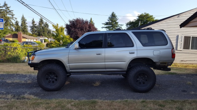

I just put those on my rig as I should have my 4x Innovations rear swing out back from the powder coat guys on Tuesday. I purchased them via Amazon.
Pic is no weight, no bumper, no spare. I don't think they are harsh even without anything in the rear. I imagine the ride will improve a bit with some weight out back too. Oh, I have no BL either.
I don't think they ride too bad with the bumper, when I have all that gear back there it rides amazing. Especially when aired down.
