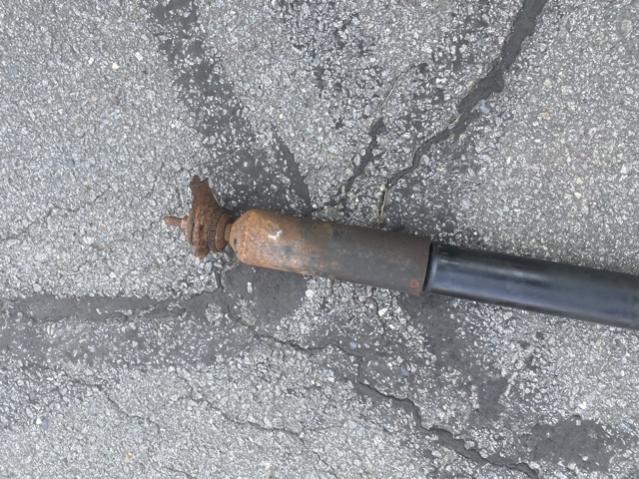

I was driving and I heard a banging sound . I found out the rear top mount of driver side struts broke off due to the rust. Does anyone know if any company makes like a fix plate or something to weld . Thank you for your help in advance

If you can't find a company that makes the special plate anywhere you might have good luck with a parts truck and have a welder weld in a used piece back in.

Toyota sells these to be welded on. Driver side 5130235040 , passenger side 5130235030
They are around $140 a piece

Wow, Toyota actually sells a replacement patch?
Gonna take that as them admitting "okay we kinda dropped the ball here" :pound:
You could weld washers in but it's best to replace those plates. Might even able to buy them used and weld them in. If need be..

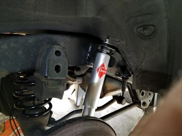

The passenger side looks like about to go too. They shop lifted my runner and where the pieces are welded on looks bad. There is rust in those areas.
He told me it would be $1400.00 for both sides
He said ,needs to drop de gas tank to do the job
Also he would weld new metal where is need it and he would coated with frame paint
I never got any weld job before
What do you guys think expensive or fair price?

If the guy does good fab work then yes, fair price. This is a lot of work to do it right. The bigger question is there good metal left in that spot to weld the plate to? From the looks of your first picture I would be skeptical. I've seen rear shock relocation kits for 3rd gens and I think Timmy/Sean even did a video on one. Might be worth looking into.

Dropping the tank may open a whole new can of worms if there has been enough rust to destroy the shock mounts.
That said, $1400 may well be a good price. OTOH, you may be throwing good money after bad.
I just rebuild my own patches and steal on. If those plates are rusted.. mostly the inner frame is rotted up as well. The wheel arches behind the tank maybe rotted through. :(
Labor rates are costly. The driver side shock coil plate wraps around that pipe and welded near the top. No way to weld a new plate in without removing the tank.
I would clean out the crossmember pipe and weld a new pipe inside of it so if the pipe is thin. You have steel to weld the plate back too.
I can see that having some costs to it as it takes alot of time. To get that all apart. As depending how rusty, could need a tank, the lower control arms strengthened with more steel .
If they are very good at it. I can see that being thwt cost or more.
I have no idea how rusted your rig is underneath. So that would change the cost depending on what is what.. :)

I have the replacement pieces that Toyota sell. The rust is not really bad it’s in one are where the piece gets weld on that looks kind of weak. . I called another shop they told me 1200 but they would fab. Everything. I feel more comfortable using Toyota replacement pieces.
Those plates are really fairly think new. I just haven't seen those plates rusted. Other damage is around the frame elsewhere... Maybe your luck is better then mine..:)
