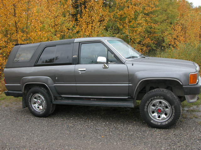

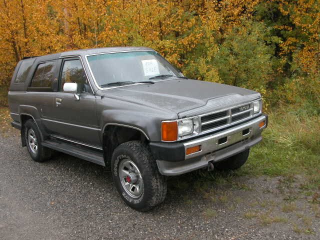

some pics to those who are interested...
any suggestions or comments, even if negative would help a lot, thanks

more pics
...:D :biggrin2: as you can see, the rear suspension is majorly sagging, i havnt noticed any harsh ride, but mind you the only rought stuff if driven it over so far is the bad washboard/braking bumps on my gravel road. any suggestions as to if and or when i should replace? im not going to go take her rock crawling, but i am planning on doing some 4 wheelin

Rear end sag is more common in 2nd gen runners, but you seem to have a real bad case of it :(
Your best cure is a new set of springs, a much better choice than Add A Leafs, lift shackles, or blocks considering the state of your rear.
New shocks all around may be in order also, if the springs are that worn, the shocks probably are also.
Check out Old Man Emu for a really nice mild lift kit. It's not the cheapest, but it'll ride and handle better than anything, in addition to 2" or so of lift.
