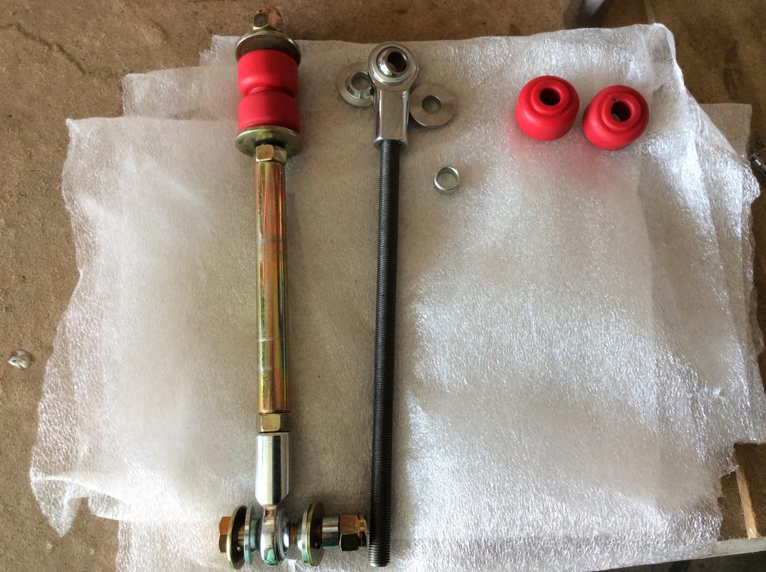

I made links just like these. Ive seen a few guys here and there running them without issue. Whats the reason not to use them? I can kinda picture the ones Im currently using not having the range of motion like the stock type would.

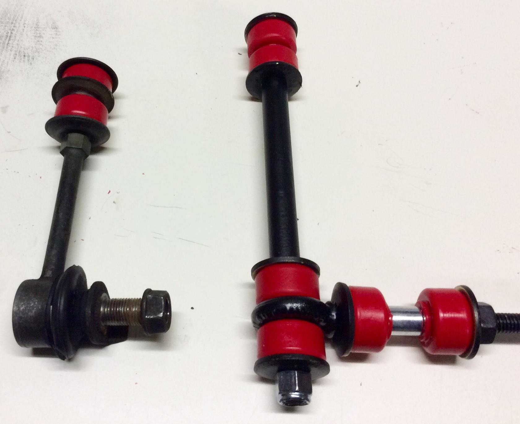

[MENTION=60930]4gin007[/MENTION] You shouldn't have any issue's ..I made these and use them on my 4th gen without any issues
[MENTION=60930]4gin007[/MENTION] And these are the ones I made and have on my 3rd gen with no issues on the right left are oem.
perhaps if they are a high quality heim. but it has been my experience that most aren't. they tend to wear quickly, and get "sloppy" and since they don't have a rubber bushing, once there is ANY play in the heim, you will hear it on every bump. being that its a solid connection, and not rubberized.

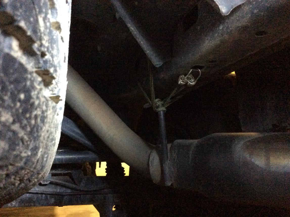

Heres mine currently as I was tracing for my tink tink and found this
Weld broke allowing mt exhaust to slap when going over dips and what not so I bungeed it til I get it welded up tomorrow.

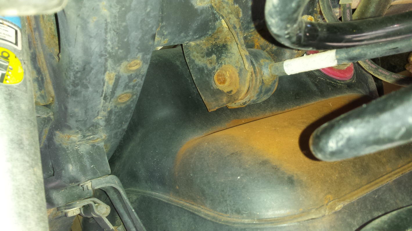

The bushing in this bar is the aHole causing all the issues, its basically gone and the dog bone is flopping around. (the bar with the white label on it)
