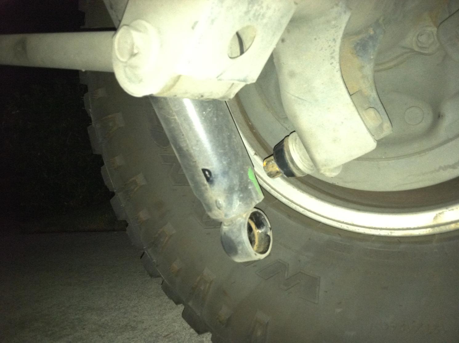

So i'm driving along :lookout: and I start to hear this rattling/knocking sound that I thought was coming from the front. I start thinking oh sh!t im going to have a LBJ failure! So I pull over and start checking everything i can and nothing is loose at all. I just decided to shake the whole damn truck and notice my passenger side mirror is loose. I felt dumb......so i tighten it up and give it another shake and now hear something is the rear making noise.
I look under there to see this.........
Has this happened to anyone?

So what do I do now? Order new shock assembly? See if toyota has the washer?
Let me know asap please. Thanks guys
You can order those parts all piecemeal. Here are the PN's
Bushing/cushion: 90385‑19007 (not sure if this is all 4 bushings, a pair, or just 1, I think just 1)
Outside Washer: 90948‑03020
Bolt: 91619‑G1222
Looks like it should be less than $10 total.
Oh, and add a couple bucks for some loctite
If your in a rush, go to sears and say ypu bought rancho shocks and they didnt come with some of the hardware, could you get the bolt and the bushing. When i did it, they didnt ask for a reciept, they just swiped some from another shock, its worth a shot if ur in a pinch.
good thing you caught that. hopefully the washer just fell out. shouldn't be a big deal since the springs still support the frame and axle. the only thing that could of happened is you over stressed the springs maybe? i remember when i replaced the rear shocks and forgot to put the rubber bushings in ..so everytime i hit a bump i would hear metal clanking..took me forever to figure it out! easy fix and felt good to get it taken care of!
Well all three local Toyota dealerships didn't have any of the parts. Looks like its going to be sitting there for a while.
My brothers 85 kept coming off no matter how tight with or with out loctite. Havnt had issues with my 98 like that though. I do know that when I was helping someone with their body lift a little while ago their shock had broke in the middle. Shock body still attached on the bottom and shaft up top and seperated. Was lucky to not have the shaft go into his nice new tires. Glad you caught it although that really isnt to bad or dangerous.
that actually happened to me, the bolts need locktite on them, mine came off when i was doing about 50 lol
Well I just checked under right after I got off work.........bolt is gone as well and one cushion and one washer. looks like i'm ordering parts soon.
