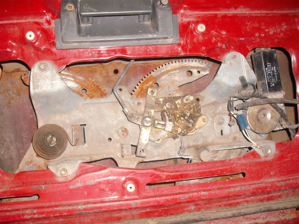

i've got one that i'm not using. was going to use it for my back window (just finished converting to pick-up), but just a thought. do you just need the motor itself?let me know if you can't find one easily!

I tried ebay but couldn't find one. There are plenty of door motors but no rear window/tailgate motors. How hard would it be to rebuild one or do you think it would be possible.
i don't think the rear would be the same as the front(s), tailgate window is much heavier.

How much you want for the motor and does it still seem to have plenty of power? My window motor is the original 1986 part. It got slower and slower until I finally had to help it close. I also looking for weather stripping and a good window channel for the rear window. My channel is pretty rusted.
I'm sure your right about a front window motor not being strong enough to work the heavier back window but it seemed strange for them to have manufactured two different window motor. I know many companies make one part becasue it's cheaper to manufacuture one single part than two different ones. The motors look identical. If your willing to sell the motor by it's self that would be great. If you would rather sell the regulator and motor I'm still interested.

The front window motor is likely used on other models, and was probably around for some time before the 4Runners. The rear window will require a larger motor, and it was likely built for this window, and has probably been used in other applications since.

the spare motor i have is from an '87, it still works, i've got the window sliders from inside the tailgate, just let me know if you want them.
I have a working motor, currently attached to the regulator. It's the original from my truck. The motor's good, but the regulator rusted out. The motor is likely rusted to the regulator, but I may be able to get it off...

Thanks for the info on the rear/front window motors. You saved me some money. I sure would like to get the motor if possible. Still got it?
Thank you for the help. The motor is different as you said. I picked up one on ebay but I'm looking to find another one for a spare.

I know this is a very old thread, but I need a tailgate window regulator, or a suggestion on how to fix the four broken teeth on mine. The few I saw on ebay have broken teeth or rollers. I just ordered new body panels and going to repaint. The window sags on one side. I bought this abandoned 4runner 20 years ago for $100.00, dropped a motor in it, and its been my daily driver the past 20 years. My grown children can barely remember me driving anything else and it's like part of the family. I recently bought a clean 1982 Toyota pickup to replace my 4runner and realized that, although I love the truck too, it's not anything near the same. Any advice will be greatly appreciated.
