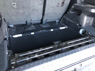

Ok so I have an sr5 with 3rd row seat and I’m going to trade someone with a non 3rd row seat with the swap we need to swap out the rear side panel since my trunk sits about 5 inches higher than the one with no 3rd row seat so I want to see what under the panels before we start taking everything apart. The swap doesn’t look hard at all just want to make sure everything is there like holes for seat belts seats and anything else
Here's from when I removed my third row and panel to install my subwoofer enclosure.

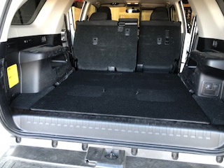

I just removed my 3rd-row seats and seat belts from my 2018. Building a platform to fit behind the 2nd row so I can utilize the space for storage that was taken up by the 3rd row. If I can answer any questions or take a few pics let me know.
Have any pics
Here's a picture of the back with the seats out and the platform I built to use the empty space as storage.
