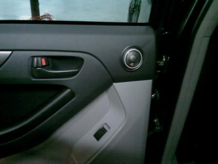

I have Polk Momo 6.5 components in front and rear. You must have got teh same deal I did at Crutchfiled. I used the flush mount cups they included and just used a hole saw to cut trhough were I wanted them. Here is a pic. Make sure you turn down the crossovers, as if you don't it is plenty brassy.
