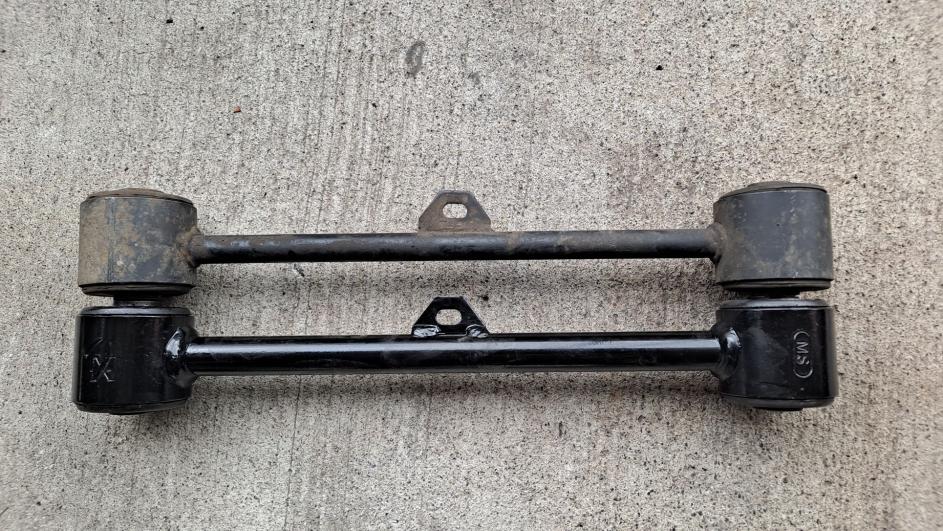

The 2wd are shorter due to the required pinion angle. Courtesy of [MENTION=139000]phattyduck[/MENTION]
I bought a pair of these recently. I'm impressed with their build quality and the improvement they made to the handling of the truck.
More Information for MEVOTECH CMS861168
Comparison of the stock arms to the Mevotech Supreme arms:
