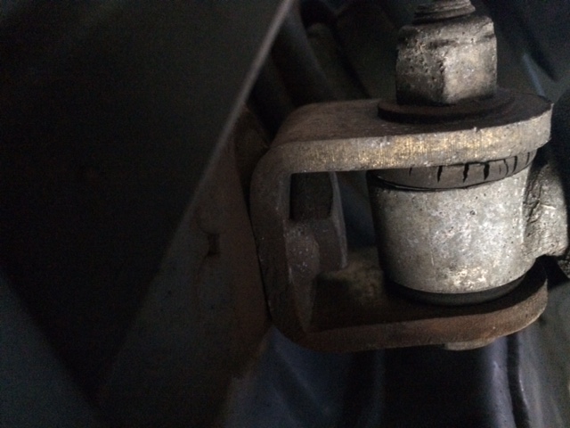

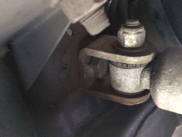

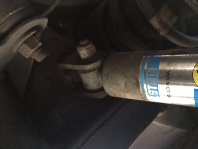

I have a 2001 4Runner with 175k miles on it. A few days ago I started getting a strange noise from the rear of the truck. Today I finally figured out what it is;
the rear upper shock mount on both sides of truck are loose. I'm not sure if that bolt is supposed to be welded or if it can be re-tighten. Any help would be greatly appreciated.

I'm assuming your talking about the bolt that goes through the shock mount up top. If so, just tighten it up, it won't be welded on.
You have a conversion bracket on the upper shock mount. The bolt is welded to the bracket, but on the other side of the frame there will be a nut that you can tighten. You wont be able to see the nut so you will have to feel around for it.
If you have small children, or small hands in general, you're in luck because Toyota gave you roughly 3 inches of clearance to get to that bolt. Dealt with that a few weeks ago. :frusty:

Threadlocker or locknuts would help.
I installed Bilstein 4600's a few days ago. It wasn't that bad. It's much easier if you remove the spare so you can reach in over the axle while sitting.
Do y'all have flex head wrenches?
I used them for my shock replacement on my 05 LC that has tiny amounts of room and was able to get to it okay.
Apologize for not responding sooner. The corvette forum emails you when someone replies to a thread. I just figured nobody responded.
I was able to lift the T4R up and remove the back wheels. Then a friend held a socket on the nut and the ratchet barley fit through a small opening in the wheel well. I put a pipe on the end of the ratchet and was able to torque down on it pretty good. I was tempted to cut the small lip that was preventing me from getting better access.
