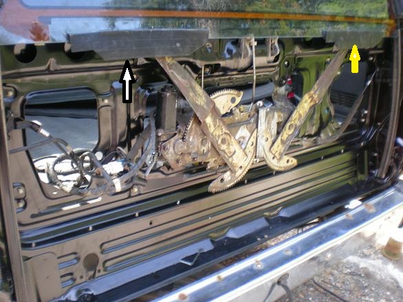

We bought my son a 86 4runner, and thanks to what I have read on this site, I have been able to get the rear window functioning correctly as far as up and down is concerned (ended up bypassing everything and adding a DPDT switch)...so big thanks.

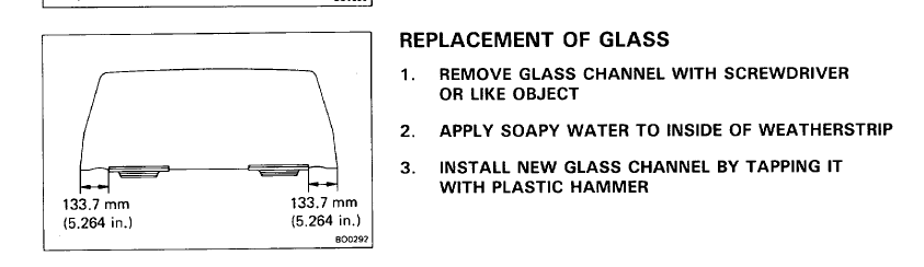

The issue we are still having is the rear window sometimes getting crooked and sometimes it falls off the lift mechanism...I found a picture that shows the parts we are missing. We are missing the two metal supports on the bottom of the window. If anyone could tell me what they are called or a part number it would be appreciated...Thank you

where did you get the price of 19.95? i looked on Toyotafiberglass.com and they want 100.00 a PIECE!! that seems outragous for these little things.
