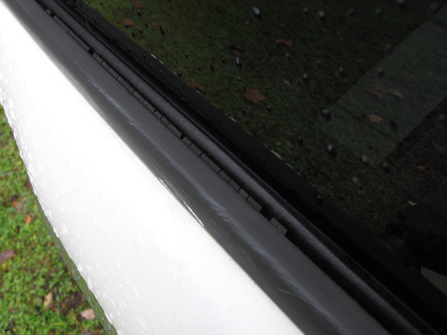

The scraper seal on my 2007 4Runner has dry rotted and I would like to replace it. Does anyone have a illustrated breakdown picture that shows the Part Number and how to change? Thanks

just did this ...
In case you still need some help and for the benefit of others ...
I bought the scraper seal at a local toyota dealer for about $32 plus tax. Some might complain about the cost but considering the ease of getting it locally, etc., I have no complaints. As to removal and installation it is VERY easy. The so-called clips that I have seen referred to in several threads are NOT "clips". A better description would be seam covers. They come installed on the piece that you buy and cover the seam or gap between the weatherstripping that covers the rest of the window and the bottom scraper/sweeper piece. Do not try to remove them. On my 2007, I was able to remove the old unit with my fingers. You might need a flathead screw driver of similar thing to pry up one end - from the inside with the window DOWN) - but it will come off. Then just fit the new unit on and press down from one end to the other. Walla mon ami! Easiest "repair" I have ever done on a car. While the unit is off, take the time to clean the body and the window not reachable when the unit is installed.
Worked perfectly
I did exactly what is said above. It worked perfectly. Just grab one side of the weather stripping wiggle and pull up. I didn't have to mess with the clips or anything.
The "clips" are part of the bottom weather stripping assembly so they come up when you pull on the piece.
It was a seriously easy DIY job.
