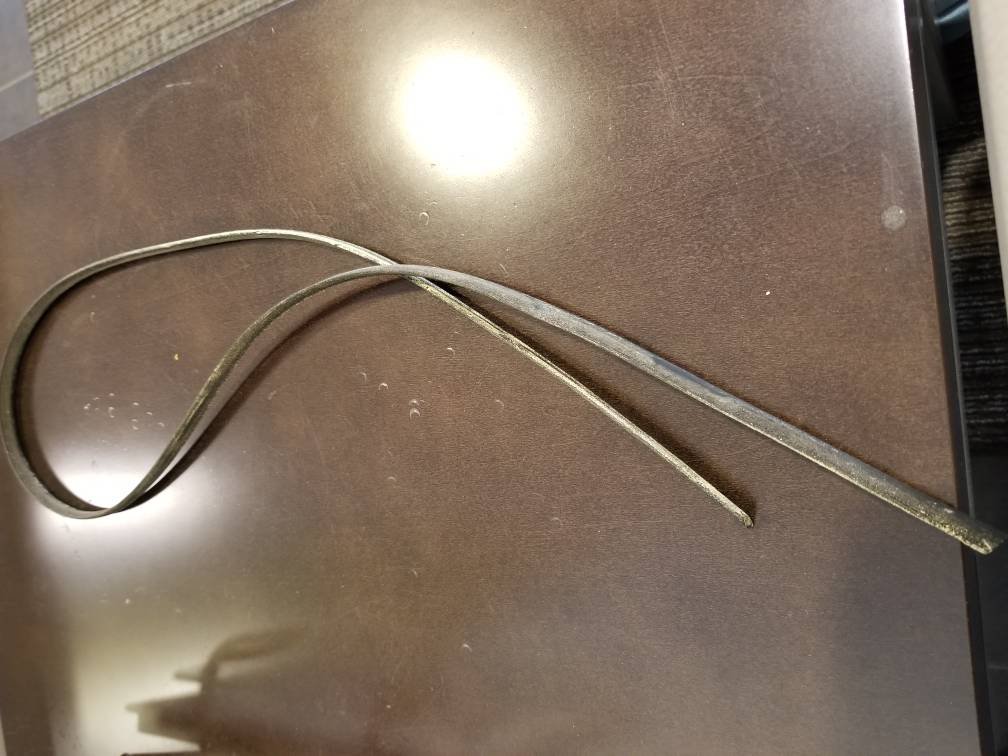

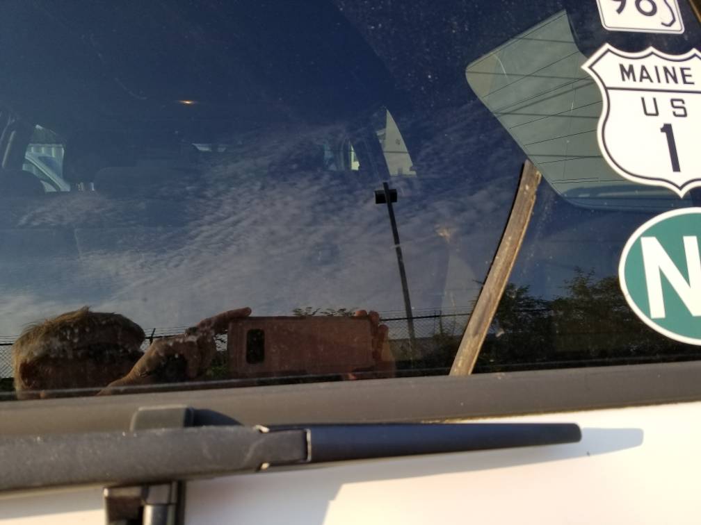

Does anyone know if I need to replace the entire rear window or can one just purchase the window moulding/seal? See pics. I assume it keeps the water out- 20190801_080709.jpg20190801_081727.jpg

You can just replace the seal (belt mldg). I think I paid $30-$40 for the part at the dealer and it took me 2 mins to pop the old one out and put the new one in. The dealer quoted me $60 for the labor, LOL.
Wherever you order it from make sure you get the outer seal because there is also an inner and the dealer initially ordered the wrong one for me.
I believe the 2 pieces are upper and lower, not inner outer
That is incorrect. There is the Belt weatherstrip that is the outer - part# 6829035031 and it the inner w'strip, part# 6829135021.

Most of the old piece had broken off mine and was inside the lining of the tailgate.
I replaced it a couple of months ago, purchased from a Toyota main dealer on eBay for $31. Part number 68290-35031 and it took 5 minutes to fit, no more leaks.

As mentioned very easy to replace, I did take a little longer than most others when replacing mine because I took the time to clean where it attaches to the lift gate and the lower area of the glass that you can't get too with the belt molding/weatherstrip installed but still done in way less than 10 minutes

How did you pop out the outer strip? The inner strip was easy enough but the outer strip is being more difficult to remove. It looks like there are clips on each end but I wasn't sure and since I don't have the replacement part yet I did not want to try too hard since I did not want to damage it.
Just pull it straight up, should come off relatively easy.
Yes, it does take a bit of effort, but once it breaks loose it comes out very easily. I would recommend pulling up each end a bit and working your way to the middle. Once it is out the new one will go back in easily, but be sure that you pay attention to seating it properly around the area of the rear wiper mount. It's not difficult, you just have to pay attention to making sure it clears that area.
I frankly didn't realize early on that mine was bad. It wasn't rotted out like some who have posted pics here. I finally noticed it was torn and that both ends did not go to the end of the rear frame. An easy fix. I also had a rear wiper had too much play because the tab in the middle of the hinge had broken off. I replaced the entire wiper assembly easily by buying a wiper/battery terminal puller at the same time as the wiper assembly. It took less than 10 minutes to do that job as well.
Thanks everyone! Glad it’s a simple fix. I was hoping I didn’t have to call a glass guy.
