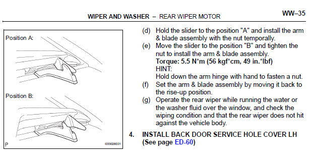

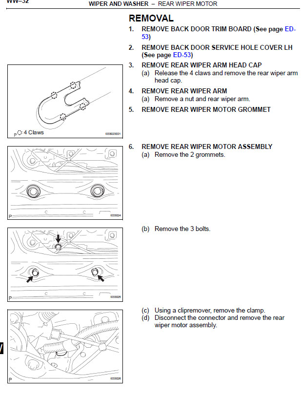

R r32 New member Jan 23, 2009 #2 Removal - From the Toyota Manual 2007 (4th Gen) Attachments wiper3.jpg 106.2 KB · Views: 126
