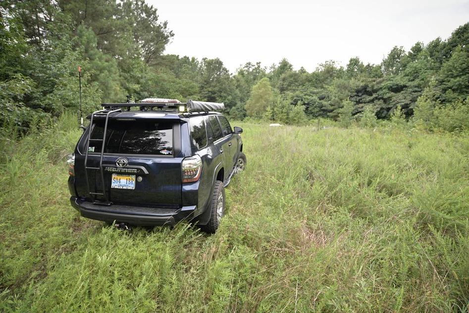

Finally hit the post requirement here is my stock to not quick build thread.
I'm currently still in school at Ole Miss and when Im not there the rig can be seen frequently traveling Eastern North Carolina and Central Virginia very on the go person.
Took a couple months to find the nautical blue trail that I had my mind set on, and after being screwed on one from a local dealer I found mine as a dealer demo up in Pennsylvania with 110 miles on the clock. The rig doesn't have KDSS. Mods started as soon as I pulled in the driveway.
Previous vehicle was a z71 Tahoe with 3 inch lift 34s tow mirrors and my ARB awning.
Objective for the Runner is a capable overlanding rig and its going to be my daily for the time being. It'll be driven till it dies.
Any questions are welcomed and I'll do my best to help anyone out on info/thoughts as the forum has been crucial to my continuous build.
The trail dogs name is DJ (Dixie Junior) and currently approves of the rear window sliding down.

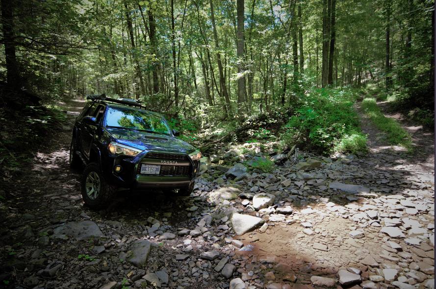

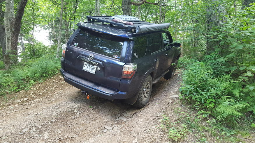

Newer hi-res photos taken with Nikon D750 full frame and 16-24 Lens

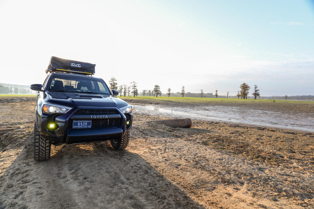

Updated shot of Lightbar and CVT MT.Shasta

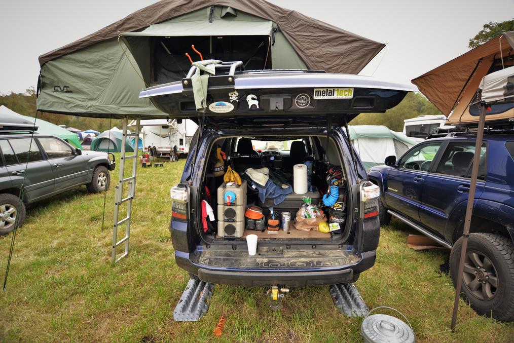

A couple recent pictures from Overland Expo East.
