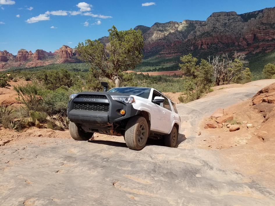

Don't bedline your wheels unless you really enjoy deep cleaning each wheel often. I thought I was an innovator until the first time I power washed them and they where still dirty af. I will likely get a set powder coated when I go up in tire size if I can't settle on something aftermarket.
I love the angle of your front bumper. Is that a simple cutting job? Any tips?
Very easy to do. I just measured down from the fender to just before the edge of the front fascia. I kinda used the SSO instructions as a guideline but didn’t go as high of a cut.
Used painters tape to make my cut reference. Cut below the tape and used a orbital sander to make my way to the tape line.
Incredibly clean work. Thanks for the description. If I get the courage to do it, I will be sure to let you know how lopsided it turned out haha
