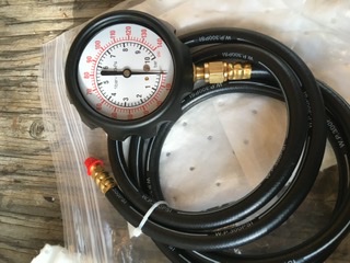

I've got the basic harbour freight one. I'll snap a pic tonight as I plan to test the echo's oil pressure.
It does not include the 1/8 BSPT adapter needed for the 4runner but the included 1/8 NPT will work if you are gentle and careful with it.

No name on it. Was cheap at HF. Has done the 4Runner, corolla and soon the echo.
I have a tach on the dash and one on my ultraguage. So yes, I note rpm. Usually get the wife to mind the rpms while I note the pressure.
The Haynes manual gives the specs on page 2c-1. Says at idle min 4.3 psi. Above 3000rpm 36 to 71 psi. Not sure how that compares to the Toyota fsm but likely close enough.
