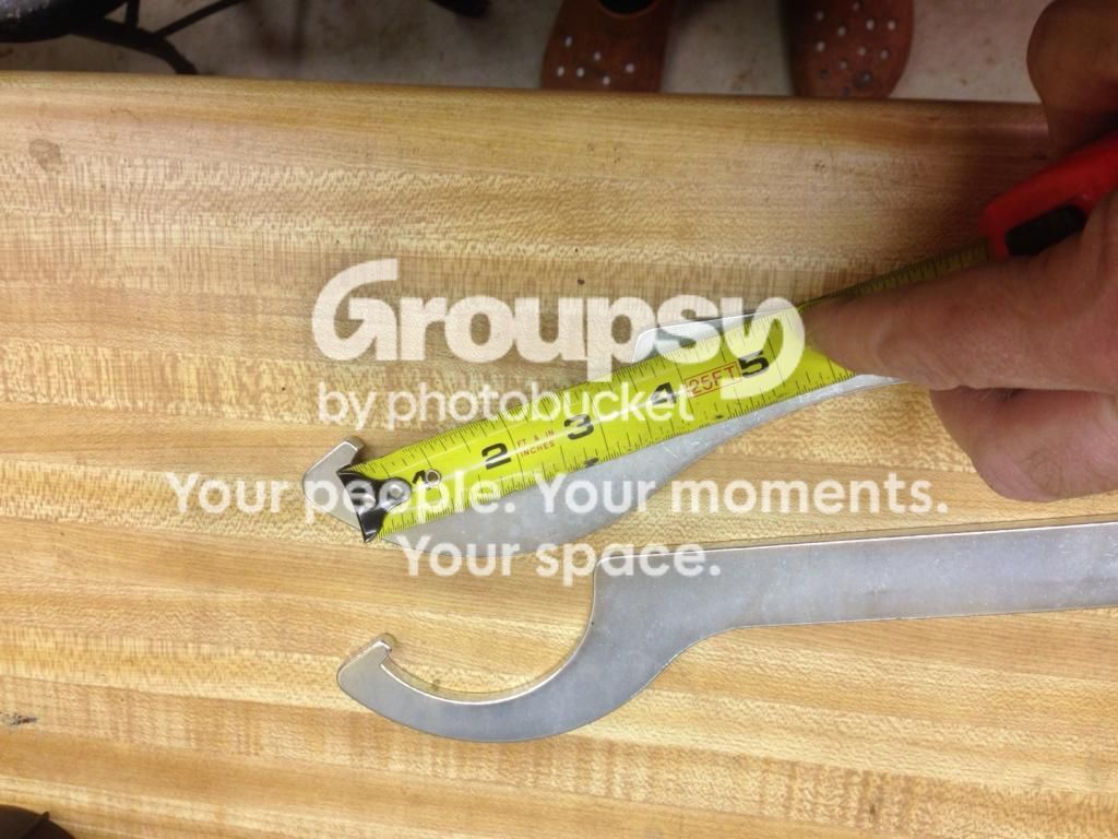

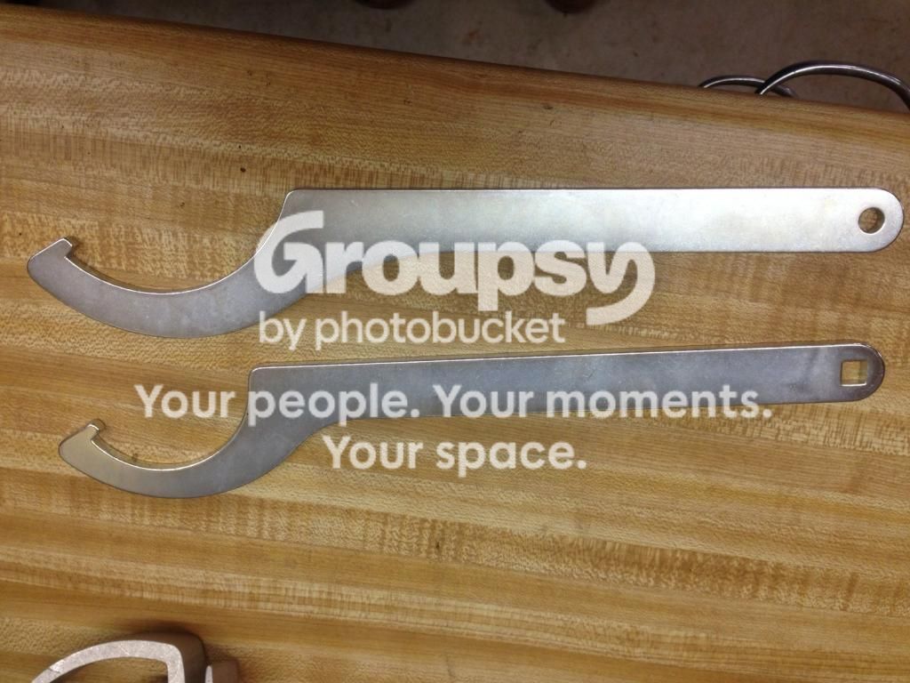

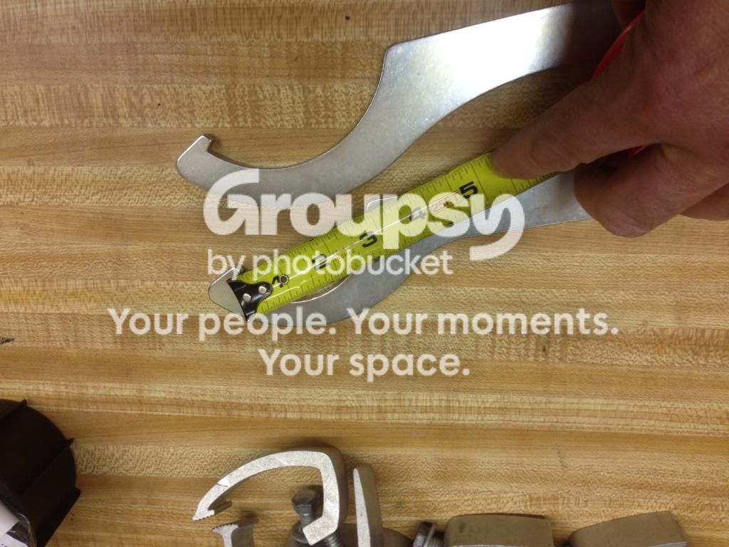

Which kit did you get? BOSS or Ultimate? I think the collars may be different on the ultimate kit. If I can take it somewhere with a welder, they can probably just weld the broken tab back on.

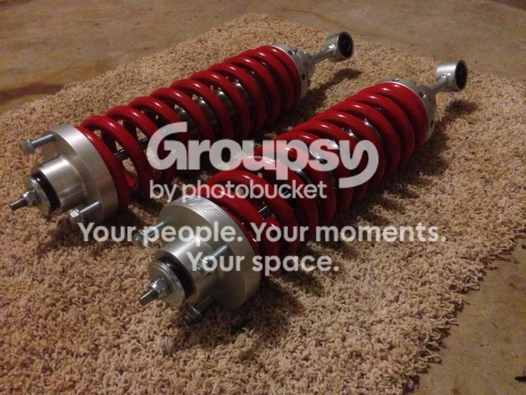

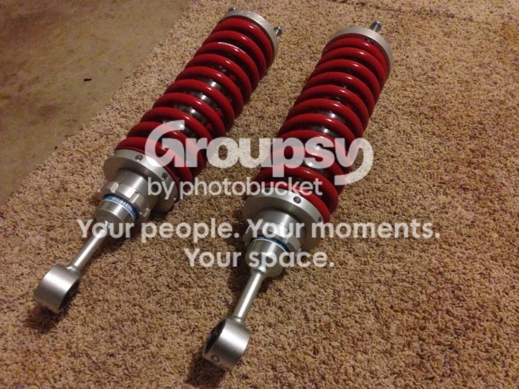

I ended up (after MUCH deliberation, back and forth, phone calls with Toytec and Wheeler's Off-Road) going with the Toytec Adjustable Coilover/Bilstein shock setup for the front - which I believe is what's in the 'Ultimate Kit'. Here's a link to the product from Toytec:
ToyTec Coil Overs (95.5-04 Taco & 96-02 4RUN)
After looking at pictures of these wrenches and the wrench pictured in the Boss kit, I believe you're right. The kit may be different and so may be the wrench. Here are some photos of the wrenches for comparison:
And here are a couple pics of the front coil overs:
