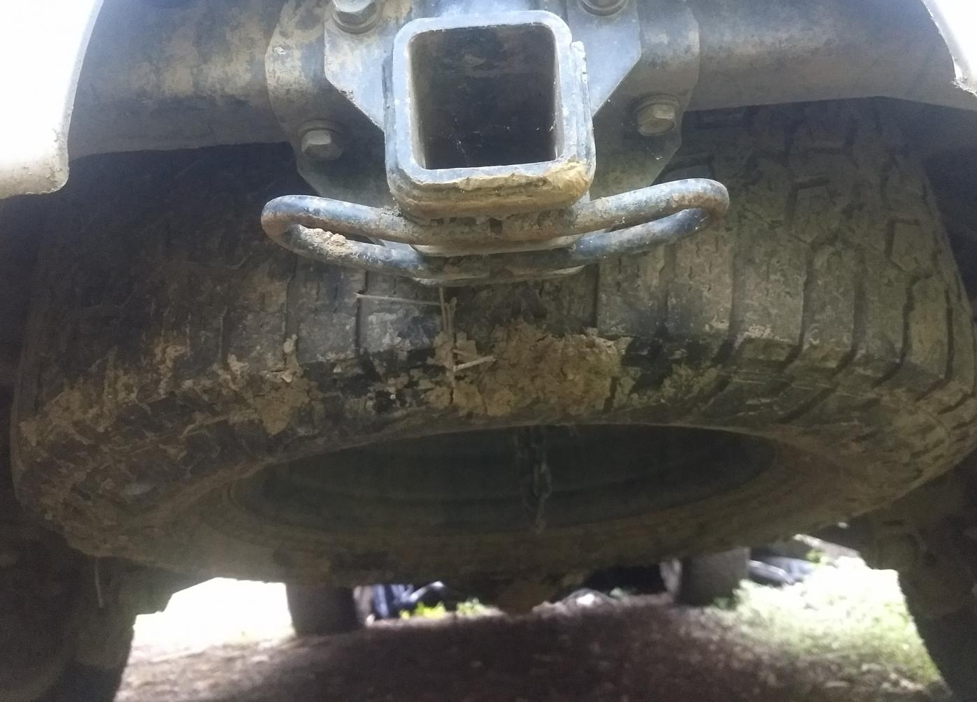

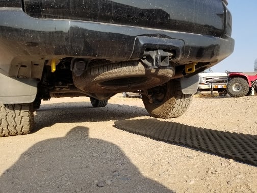

Is your spare under there too? I drag as$ on that hitch recovery point too �� but most of the time my spare drags first acting kind of like a skid plate. It hangs a little lower than those recovery points with a 33. So I just drive through it. I don't have rust problems here but if it gets to be in need of a little love I would just resurface the steel and use a good paint on it too keep it in good shape. Mine after over ten years of abuse. Original coating still good.. Notice the mud on the tip of my spare. It seems to be in the perfect spot to keep me from hitting that hitch in most cases.

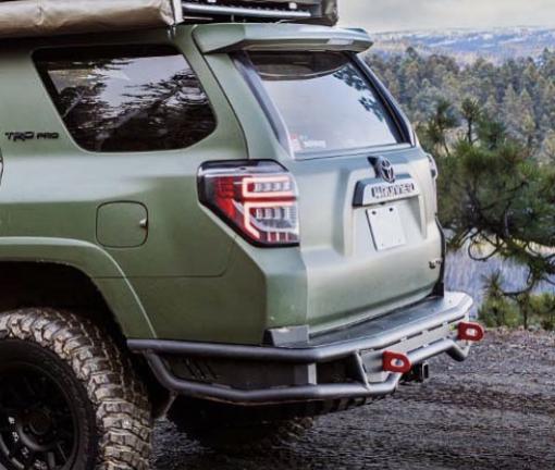

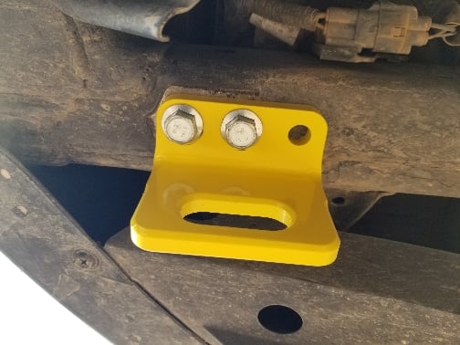

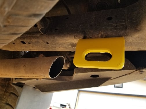

Those yellow recovery points seem a little weak with just two bolts. Also, they appear to be next to an intact exhaust. My exhaust is bent into a raising, so those recovery points will likely get hit too. I’m thinking of something I can mount directly behind the rear cross member like the Ironman bumper pic below.
Jake, y’all got mud, but we have rocks. The spare can definitely catch on them but it’s not been nearly as bad as the receiver. The loops are all bent and the recovery point that sticks out another 5 inches just hits everything

Oh we have rocks! Natural stone galore. I just don't hit pointed ones I know will catch . Your idea of mounting them on the rear cross member is good. That guy has a custom bumper in the picture. You could mount one on the factory rear cross member on each side of the hitch in my picture in the same method as the factory front recovery points. Drill through cross member and weld in recovery loops on front and backside.
