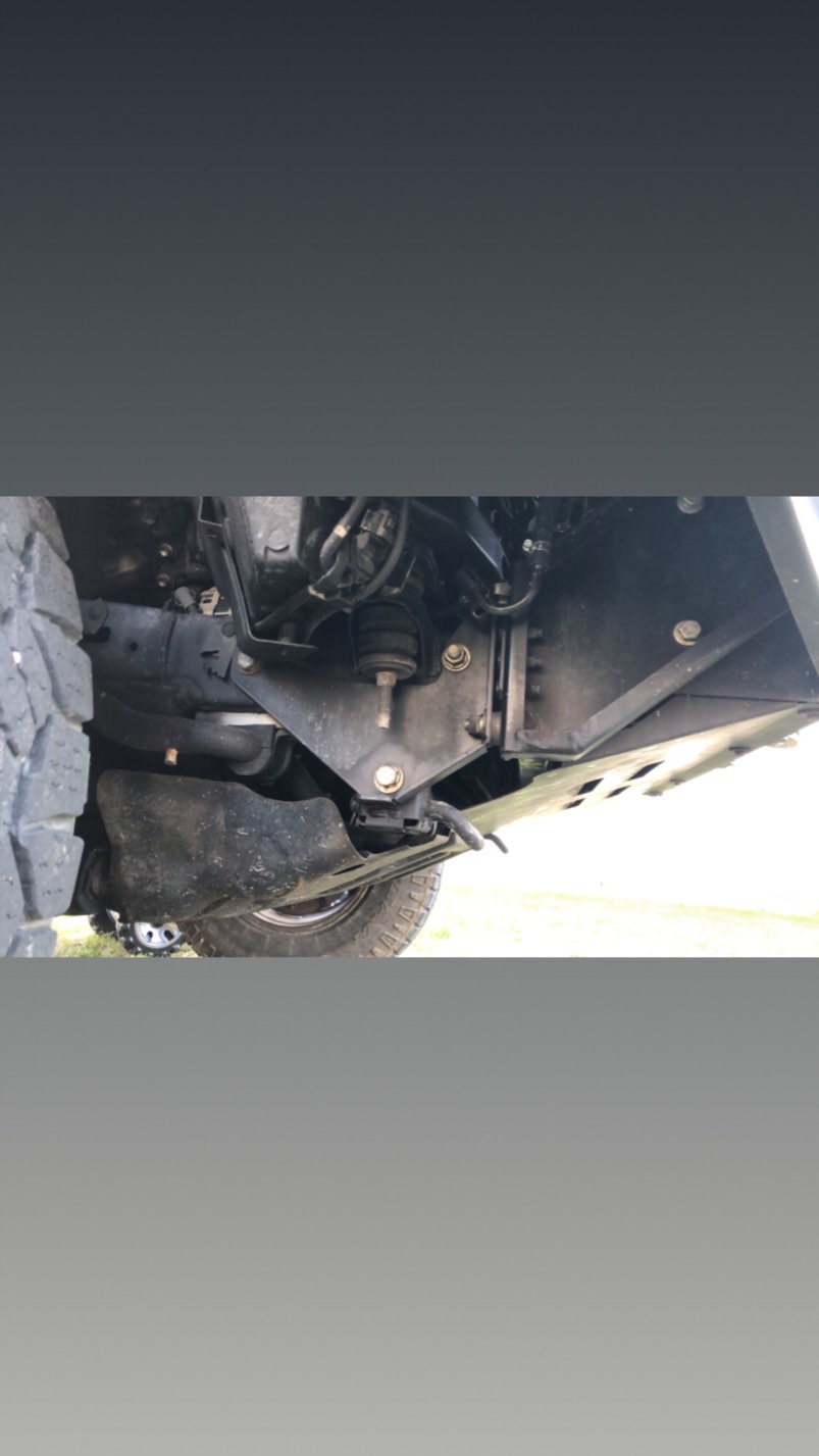

This is the front mount on the ARB.

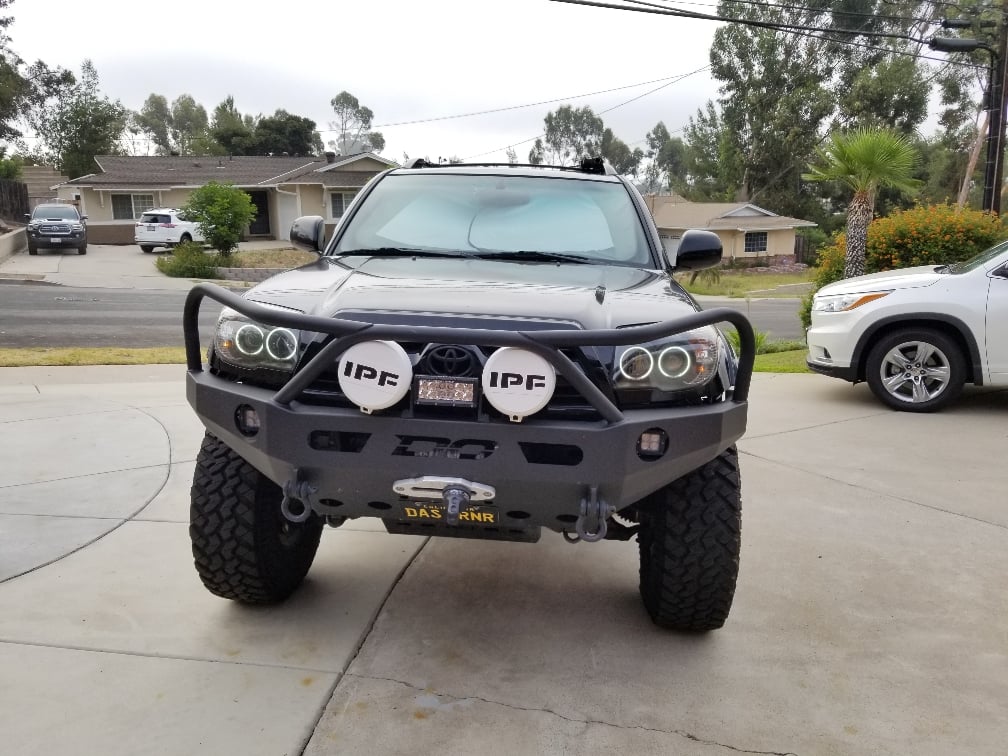

That's the main reason I went with Shrockworks over ARB. That said, I believe you can buy an add-on recovery point from ARB.

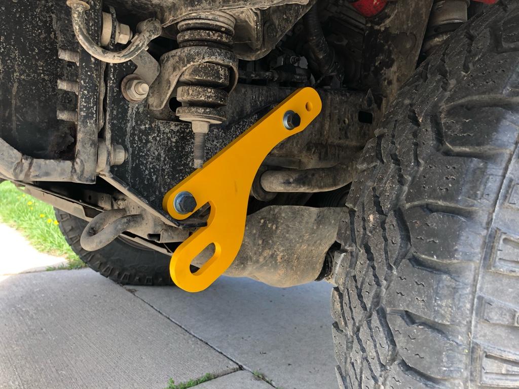

Just confirming that these fit great with the ARB bumper on a 4th Gen.

Did you have to remove the bumper to access and remove the nut from the upper mounting point?
I didn't.
I was able to get the ARB hardware out, and the new hardware in through the larger hole towards the rear of the truck. It's a bit difficult, but not too bad.
-Rob
