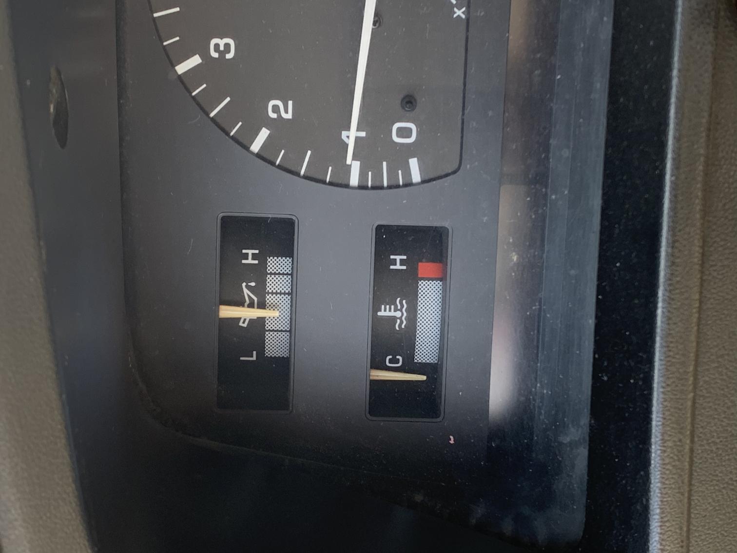

Quick question on oil pressure, this isn't too low, is it?
I know at idle the oil pressure drops a bit but it was regularly below the lower line, at some points on the trail today it was halfway in the lower zone.
My idle is a little low, I plan to bump it up after a quick check for vacuum leaks. I just wanna make sure the engine isn't being starved.
Idle oil pressure
I enjoyed reading through your thread and just took this picture on my lunch break. It’s a rebuilt engine that I just finished dropping in a couple months ago, but it hasn’t been driven yet (clutch issues) but this is the pressure I got while it was cold and at idle. I don’t know too much about cars yet so I don’t know if oil temp will have an effect on the pressure (although I’d assume hot oil would have a higher pressure) but hopefully this gives you a baseline to work with. Let me know if you want a pic of it warmed up at idle
