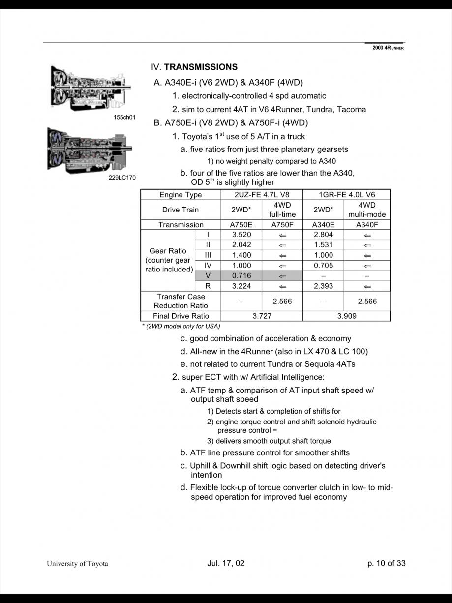

A750F-i gear ratio
After my last trip up 88 I figured out what I want out of my next gear set. Check out this chart to help make your decision. What I determined was that V gear aka 5th is 29% lower than 4th. That gear has been useless to me for anything other than long downhill grades since the dawn of my 35s. In 4th I’m pulling 2K at 70mph. So with my public education math skills, I decided to go roughly 30% deeper to get 5th gear back. 31% to be exact. :nerd:
3.727 x 1.29 (29%) = 4.80783. So 4.88 it is then. On the other end of the spectrum, the rest of the gears will now be 31% lower as well.

I had ECGS built my 3rd member and clamshell when I decided to re-gear.
I am on 35's with A LOT of added weight. Steel bumpers, full drawer system, roofrack with hardshell RTT that stays on, winch, added armor, etc etc. I went with 4.56 gears because initially running 35's stock with the V8 really didn't seem to phase the rig at all. Plenty of torque to get around. My thought behind the 4.56 gears was that I'll get a bit closer to stock ratio while also retaining some beef in the ring/pinion since it's a well known fact that the higher to go, the smaller/less beefy the gear set gets.
With that said, after running this setup for the past year, I can say with confidence that I probably should have gone with 4.88 gears. Your math is pretty sound and I second the choice.
4.56's do OK, and I don't have it kicking down on my drives, but I also haven't done much mountain driving.. Offroad they do ok in 4lo with lockers, but yea, if I had to do it again I would definitely go 4.88.
Also, locker upfront.. yea.. I'm running ARB front and rear with RCV axles in the front. I can tell you first hand that yes, a locker is nice to have... but these front ends are tiny... I exploded the intermediate shaft and housing while fully locked, granted I had built up some wheel speed and then jammed my front passenger tire up against a giant boulder that made it come to an abrupt stop.. but nonetheless... you have to be careful with these tiny diff's we're running, especially if you have any weight to the rig like I do.
I'm really curious to see how these front ends hold up with all these guys running the RCLT kits with 37-40in tires :)
I only re-geared my front and rear to 4.88. ECGS did my front and a local shop did my rear, i removed and installed myself. tried to rebuild myself too but its kinda technical, gotta get the right torque on the bearings and the preload. I couldn't quite dial it in myself, shop said i was real close though. Upgrade to a solid spacer while you're re gearing as well The difference compared to stock is incredible. I get the same gas mileage with 35s as i did with stock diff and tires. Huge upgrade for wheelin too, runner almost idles up the trail. lol
4.88s with 37s work great with my vvti V8. Can drive 80-85 on the interstate and keep up with traffic between Denver and Fort Collins. Also headers and dual x pipe exhaust.
MPG is calculated to be 13 or 14 from Kansas to Colorado, uphill. Back I didn't calculate but its usually 1 or 2 higher driving downhill.
When I had 35s with the 4.88s for a short time, it felt almost fast.
