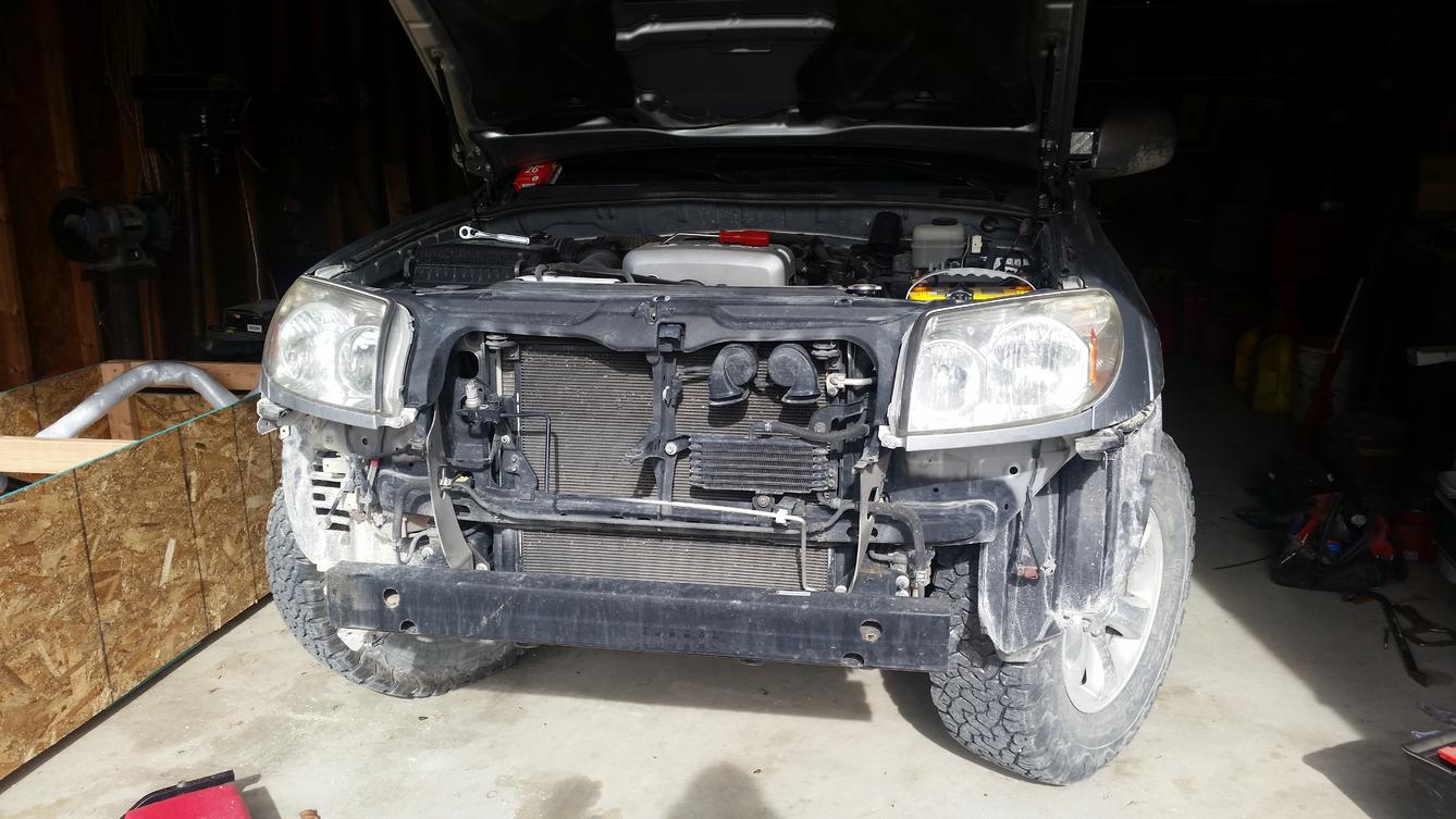

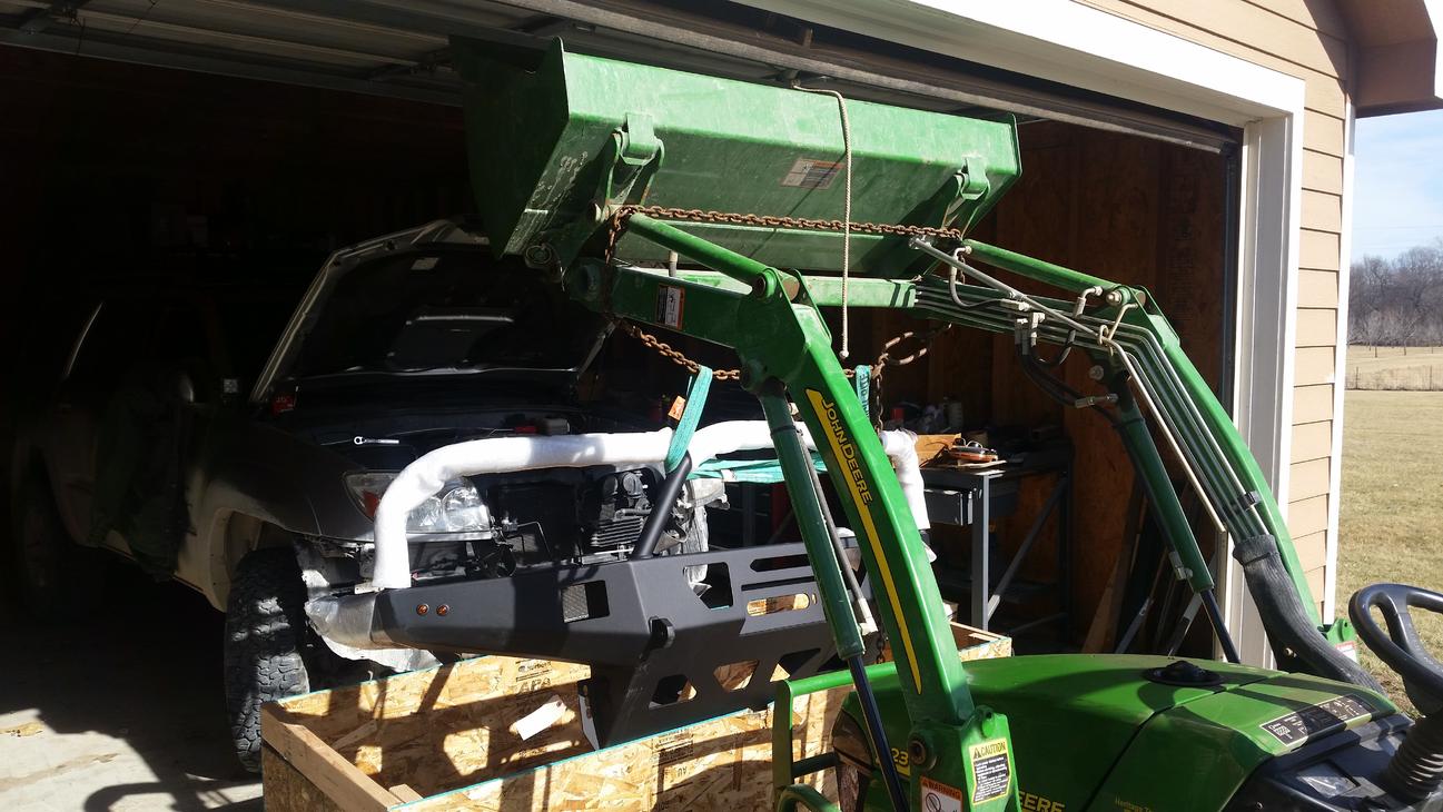

Installing a the Relentless Fab Predator front bumper today. I didnt get any instructions with so if any1 has installed one of these and still has the instructions you would be a life saver.

I got the stock bumper off with a little help from a youtube video. This is the first Toyota I have torn into so Im not super familiar with how it goes together but it has been very simple so far.

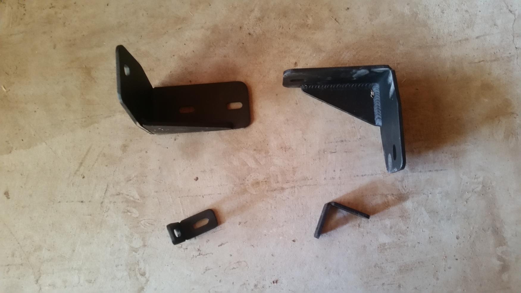

I can see how the new bumper attaches but I have 2 pairs of brackets that Im not sure were to install or when to install. The bigger one in the pic below I thought i figured out but the supplied is not nearly long enough for the job. I just guessing now. I have the winch installed now on the bumper and I ready to put it back together.
The big ones are probably bumper mount supports, which bolt alongside the frame rail in front of the sway bar mounts and below the front body mount bushings to help tie in the lower part of the bumper. Sounds like you figured this out, but they are too small?
The small ones, I'm not sure. Probably brake line or AC line relocates.

They should be Emailing you soon Brittany the customer support lady is super nice and attentive. The little brackets for me at least when i had a relentless fab bumper were for the pod cutouts to adjust the lights. They should have included hardware no? [MENTION=115845]alpinhi[/MENTION] Also these are the instructions for the DIY kit for 03-05 not sure if it helps but it does talk about mounting. https://cdn.shopify.com/s/files/1/0..._bumper_instructions.pdf?10295635418915727528

The small brackets are definitely for the cube fog lights. I'm not completely sure on the larger brackets but if I had to guess I would say they are probably frame supports of some sort. I have the DIY version (I still haven't finished it :frusty:) and I don't have any brackets like that. I've had good luck getting ahold of Relentless Fab in the past though.

Ever figure out what the larger brackets are for?
Did you all ever get an instructions emailed to you? I just received my RF summit bumper. I've watched some YouTube on removing the stock bumper but curious about how the RF brackets get installed. I looked through a CBI install thread, it had 4 brackets by the looks but maybe it's similar in installing? Thanks for the help!
