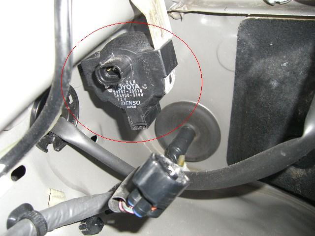

I have an 02 4Runner Sport Edition. I bought it used from a dealership. It's in excellent shape and has great miles (84,000). I'm loving it.
However when I bought it I only received one key. Now that winter is upon us, I'd really like to have a keyless entry. How do I find out if my 4Runner had factory keyless entry?
Also if mine did not have a factory keyless entry option, what options do I have?

On my '02 there is a small unit under the hood that chirps when you use the fob.
It's in the back corner on the passenger side and looks like this..

OK so I popped my hood and I have this exact item on the passenger side of my engine compartment. So you are saying that with this item there it's safe to assume that my 4R had keyless entry from the factory?
All I have to do now is order a new fob off of ebay and program it to work with my truck and I should be good to go?
Yes!
Yes!
HYQ1512Y
I had to do the program procedure twice, but everything worked the second time. Lock, Unlock and rear window. Hard to believe it was so easy.
